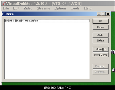

  7. Unfortunately, the Crop dialog doesn't show you the dimensions. But when you're back at the main Filters dialog you can see the remaining frame size:

    That's super helpful, it would have never occurred to me to look at again at the filters dialog. Thank you jagabo! And thanks to everyone else for their responses as well.
