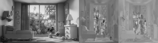

  8. Originally Posted by jrivord View Post
    Every method I have tried creates a picture that is flipped and looks like pink snow.
    It sounds to me like you are sampling YUY2 incorrectly. Or maybe you have a signed vs unsigned problem. First verify you are selecting the Y, U, and V components correctly -- ie build RGB from only Y (R=G=B=Y) to create a grayscale image. Make sure that looks right. Then do the same form U and V (they should be half width). Here are Y, U, and V from an image separated into planar form and stacked horizontally:
    Once you have that worked out work on the YUV to RGB conversion. I would use the equations from here:
    http://msdn.microsoft.com/en-us/library/Aa904813#yuvformats_2
    That appears to be the standard rec.601 conversion which most standard definition (and lower) video should use. That's equivalent to your 4th method.
