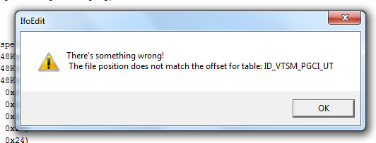

However, I don't know how, it worked by re authering the DVD using DVD Shrink, I muxed using Muxman joining my subtitles then I replaced the vobs using VobBlanker, anyway I'm getting a new kind of shitty situations I've never been to, I opened the resulting DVD in IfoEdit to modify some info but what I've got is this:
of course this message was followed by loads of error messages so I doubted I made something wrong so I went back to the original copy and tried to modify it but I've got the same problem!!
Can anyone help me out PLZ
