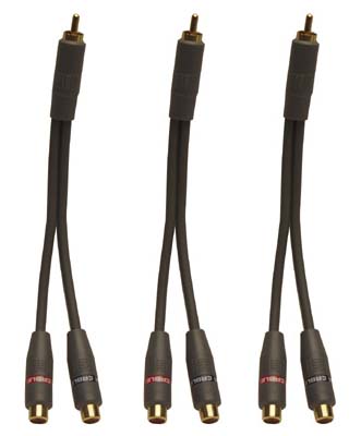

    I had to use splitters on my Component cables to connect the component out from the SA8300 to both the HD-PVR and the TV. I also had to use digital coax out with an optical adaptor to get audio to the Hauppauge. I tried to use an optical splitter but the Hauppauge wants optical passthrough to work and if you turn the Hauppauge off then you don't get audio passthrough to the reciever. Somehow it's able to get audio with the coax converter. I have an optical out from the Hauppauge connected to nothing to fool it into passthrough to get it to work.
    The splitters that I used were just heavy audio splitters but they work. You could buy a Component splitter off the internet.

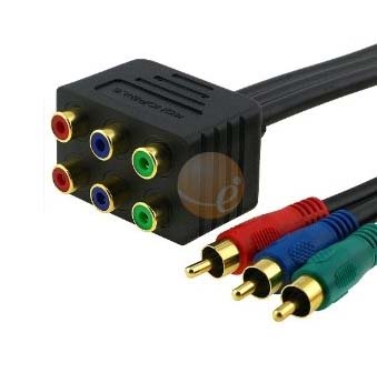

    Splitters create an impedance mismatch that will affect levels and picture quality. Better to use a component distribution amp to keep quality.

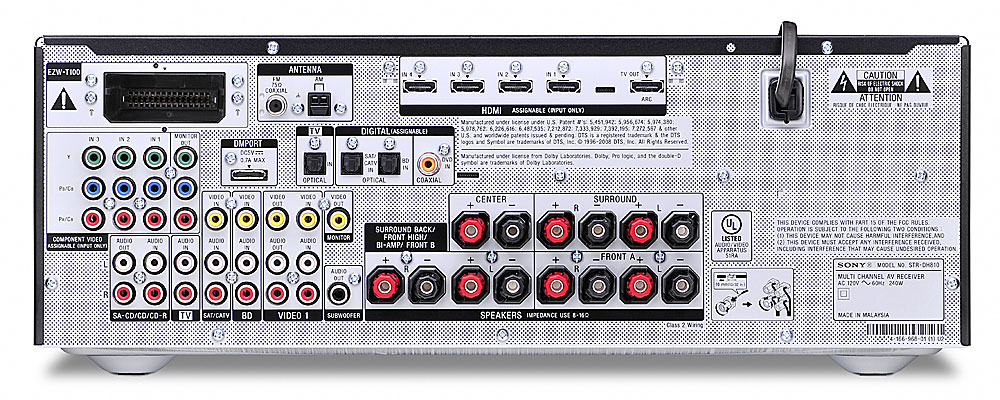

    Could I use the HDMI out from the cable box to the HDMI in on my Sony STRDH810 and use the HDMI out from the Sony to my LCD and the Component out from the Sony to the Hauppauge HD-PVR to get around the cable company killing component out or use the Reciever as a component splitter? Well, after looking at the manual, the first question is no. I'll have to try the Compoment cables.

    Even if your receiver is capable of HDMI to component conversion, HDCP prevents this from being done from an encrypted set top box feed. The box will refuse to output if the receiver attempts to decode. You can test this now. Send HDMI to the receiver and component to the TV.

    It says in the reciever's manual that if you hook up HDMI in that it will not output video from any other video outs or audio from the audio outs. Only from the HDMI out.
    I know already that the COX cable box kills the component out if I have the HDMI hooked to the TV. That's why I had to split the component out to the TV and the Hauppauge. Well, I could've ran it to the hauppauge and out to the TV but it won't work if I turn off the Hauppauge and I don't really want to have to leave the Hauppauge on when I'm not using it.
    I have no idea why the audio won't work in the Hauppauge unless I have it hooked the way I do. I always thought passthrough meant it would pass the signal through without the unit being turned on. That's how every other device I've used worked. I wasted my money on the optical audio splitter (it works, just not with the Hauppauge) and would've had to buy the coax to optical adapter if I didn't already have it.
    EDIT: Nevermind, I thought it had one component input and three outs but it has three inputs and one out.
