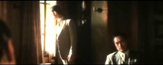

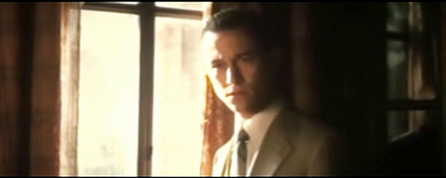

  5. i have use the "levels" filter before with good results, but maybe this video is TOO bright. I have 2 snapshots taken with VLC. all the setting in vlc are at their default levels.
  6. That's probably too far gone. But did you try the brightness trick I gave in the earlier post? That is important because VirtualDub converts incoming YV12 into RGB using the standard rec.601 conversion matrix with a contrast stretch. That means very bright portions of the image are washed out, and very dark portions are crushed. The Brightness/contrast filter apparently works in YV12 if it's the first filter in the chain (at least in fairly recent versions of VirtualDub, ie 1.9.x). Turning the contrast down will allow you to retain those over-bright details. That gives later filters more bright detail to work with. Also try gradation curves in VirtualDub. http://members.chello.at/nagiller/vdub/index.html
