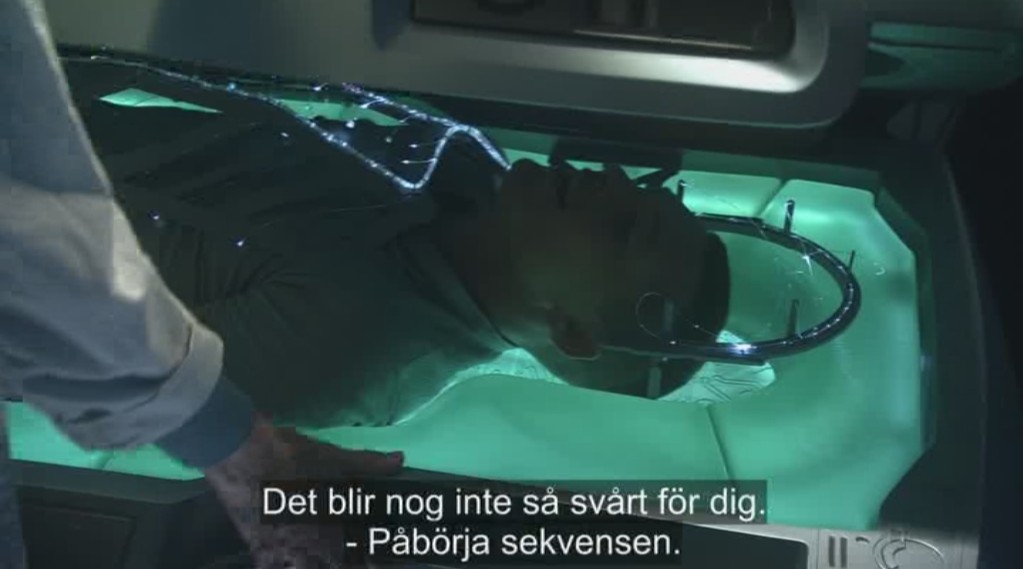

    Aug 2004
    No need to cut out pieces.
    Just open the mkv in WMP and se see how it comes out with various schemes.
    It will look exactly the same after encoded with FAVC.
    I'm doing it myself all the times.
    Here is a sample taken from dvd encoded with FAVC:
