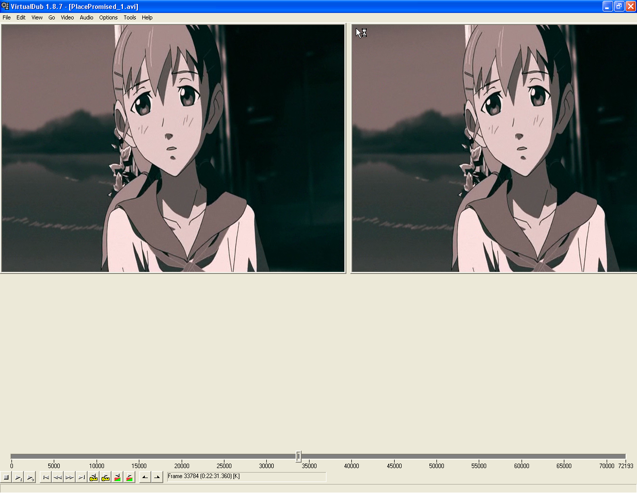

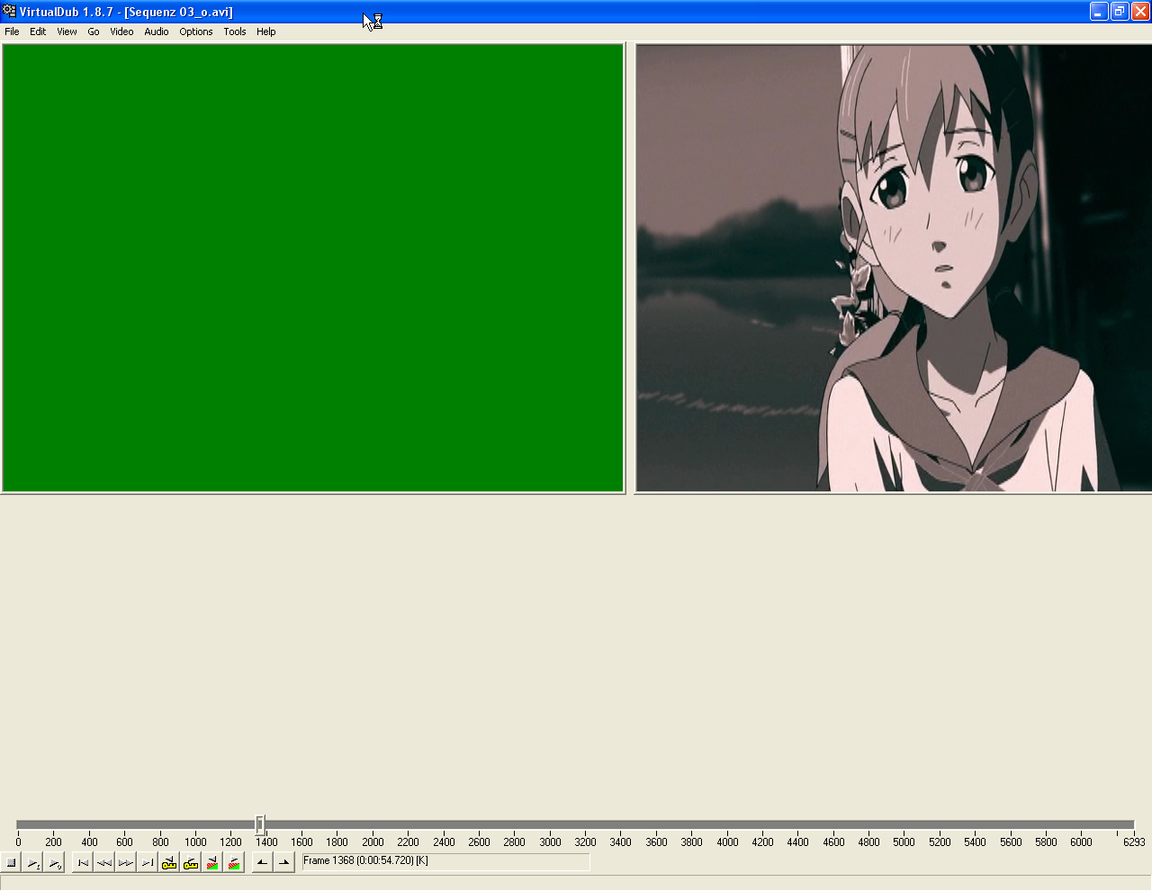

    I take everything back! It is Premiere that is causing this!!
    Look at these two pictures
    The first one is the uncompressed first output of Vdub!
    The second one is the uncompressed output of Premiere!!!
    But what now - no more cutting in Premiere?? o.O

  5. As mentioned earlier, Premiere has a crappy deinterlacer and resizer
    But your comments still don't add up.
    If the original was interlaced, the 1st shot should out of vdub show combing (aliasing) if it was unprocessed in vdub (no filters) . If the orignal was progressive content encoded as interlaced, then it was likely a setting mismatch in premiere. Eitherway, there are ways to make everything work properly

    Well as said the only one filter was the resizing in the 1st step in Vdub
    I will try it out right away^^
