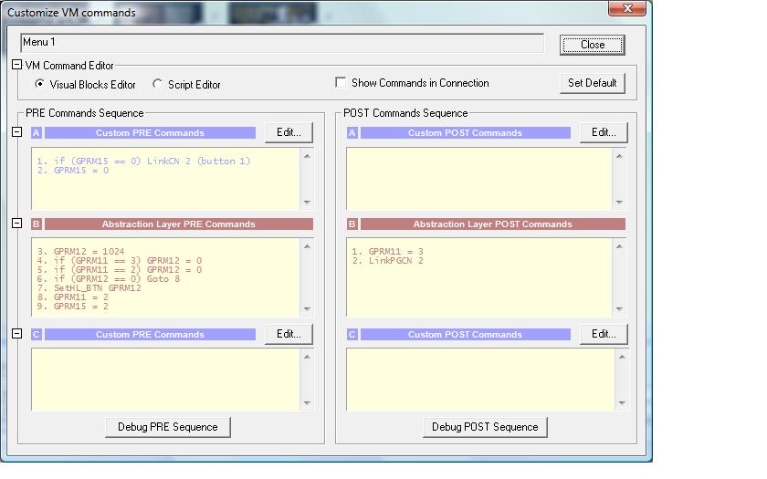

  10. right it still not working when I make the dvd and play in WMP
    Here is hwat I have:
    Looking at connection in DVDLP:
    I right click on first play which is a green icon.
    I click edit on PRE Commands sequence for box A on the left
    on Line 1 I have: GPRM15 = 1
    Next I right click on Menu 1 in connections and choose edit VM commands.
    Again I choose custom pre commands, box A on the left to edit it.
    Contents are:
    if (GPRM15 == 0) LinkCN 2 (button 1)
    GPRM15 = 0
    On Menu 2 - The button to go back to menu 1 is just links to menu 1 and has no commands.
    Any ideas?

  11. Member Alex_ander's Avatar
    Oct 2006
    Russian Federation
    GRPMs 11-15 are already used by DLP internally and can't be used for custom programming (there's a warning in help file).
    What do you see at playback?
  12. I noticed that too when I took the screenshot so I changed it to GRPM4 but its still not working.
    The dvd plays as normal when it is first played, so it goes like
    Menu 1 (cell 1)
    Menu 1 (cell 2)
    But when I go to menu 2, then click on the button linked back to Menu 1, it plays cell 1 for some reason.
    Not sure what I am doing wrong..
  13. Ha - got it working now, I has missed one of the GPRM15's and should have changed it to a 4!
    Thanks!
