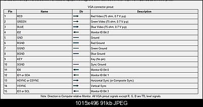

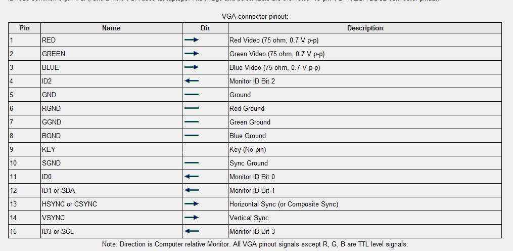

    Hmm, normally "premium" long VGA cables have double shielding.
    Also, it could be this cable is missing pin 11, 12, 4, 15 (ID0, ID1, ID2, ID3) wires needed for monitor identification (older standard).
    The newer standard E-DDC uses fewer pins.
    from http://en.wikipedia.org/wiki/VGA_connector

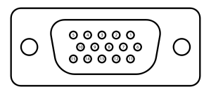

    I'd return the cable and get one with all the pins connected and with double shielding.
