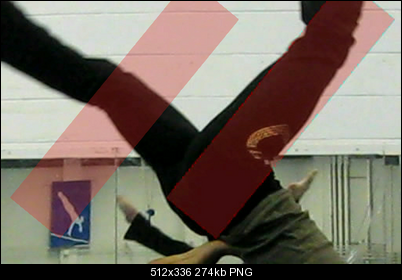

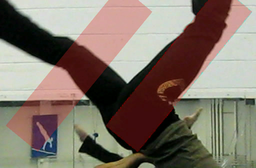

  4. Are you seeing those artifacts before compression or after? Here's what I see using Overlay() and the overlay image shifted to the left by 200 pixels.
    src=ImageSource("wtf.jpg").ConvertToRGB32()
    over=ImageSource("1.png", pixel_type="RGB32")
    alpha=ShowAlpha(over)
    Overlay(src, over, mask=alpha, x=-200, y=0, opacity=0.30, mode="blend")
    working in RGB:
    after converting to YV12 (4:2:0 chroma subsampling):
    The second image was made by adding ConvertToYV12() at the end of the script. All high compression codecs work in YV12. What you're seeing is worse than just 4:2:0 chroma subsampling.
