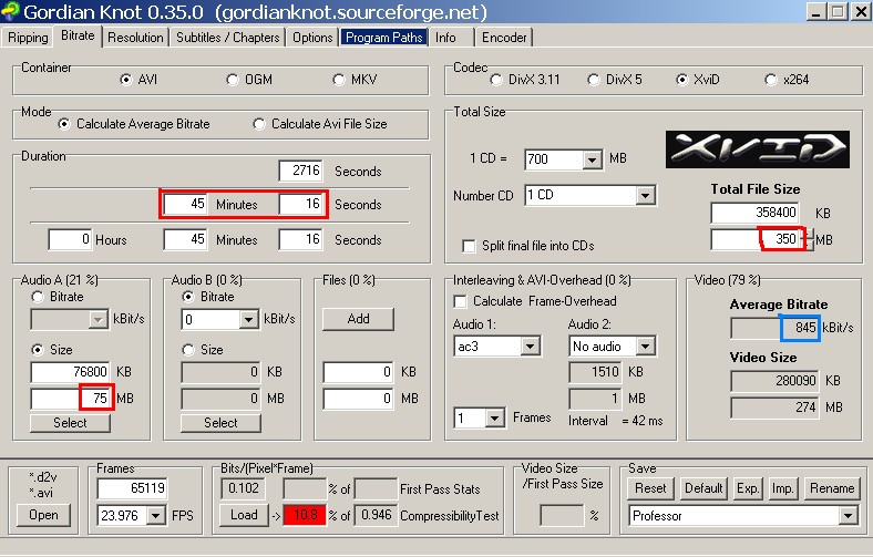

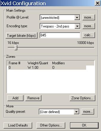

  4. Originally Posted by s_joy09 View Post
    How am I to go about ?
    At the risk of repeating myself, you use a bitrate calculator. I use the one in GKnot. You fill in the length of the video, the size of the audio, and the final size (in red), and it spits out the bitrate (in blue). Then you stick that number into the bitrate part of the XviD Configuration panel. Here are pics:
Name:	XviD Configuration.jpg

    In VirtualDub, when you select Video>Compression, you will get a window that will list the codecs available. On the right side of that same window is a button that says "Configure." First, select your Xvid codec from the list on the left, then hit the configure button to calculate bitrate and do your settings. I would also convert the audio to mp3 instead of ac3. Mp3 works better with Xvid, while ac3 works better with MPEG-2.
