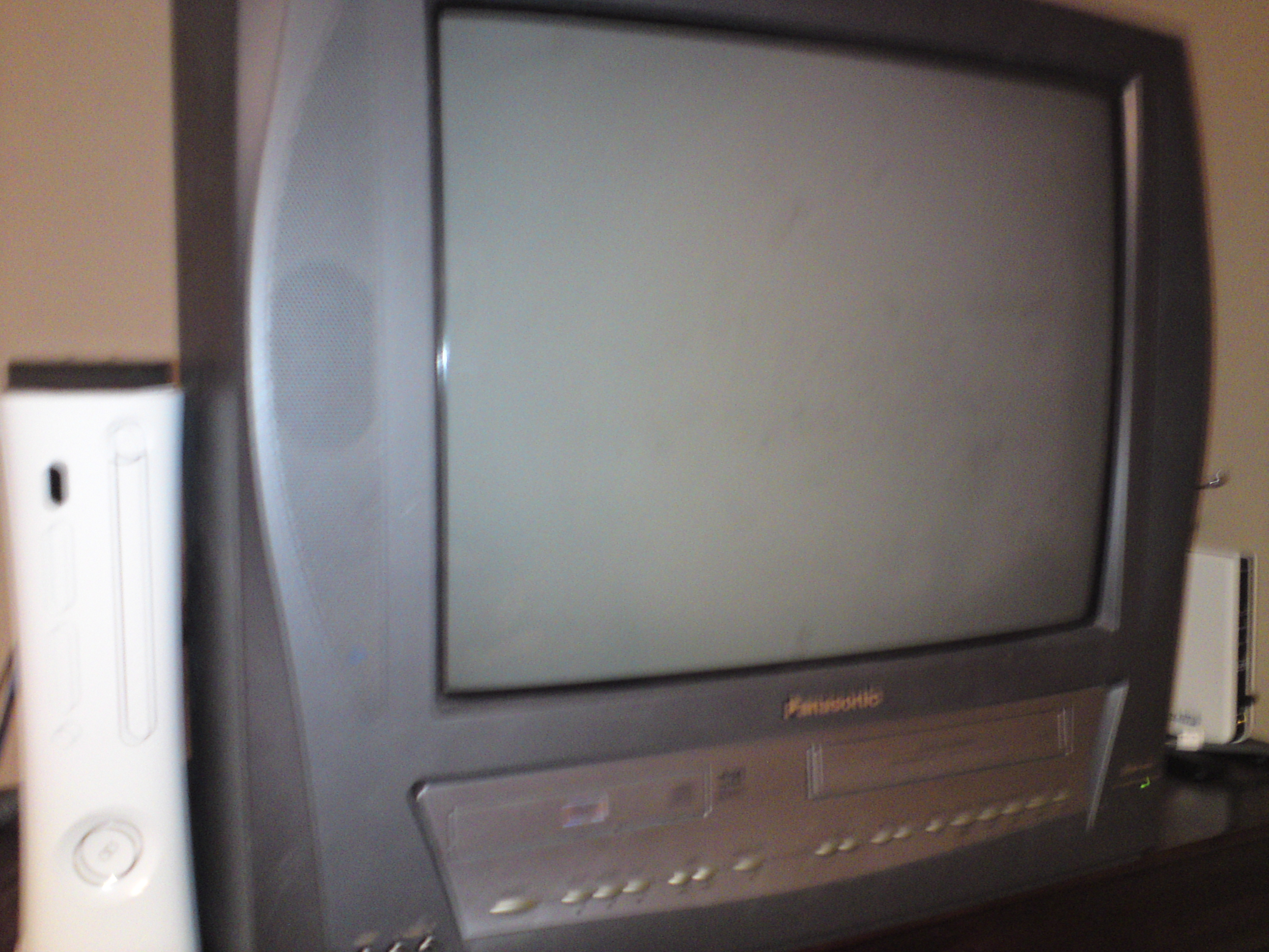

  13. That is a good idea, which i never thought of, and am definitely willing to try. However, a VCR? that might be tough around my house... but i got a thread going on Microsoft forums, and someone is telling it can be used for just that: http://forums.xbox.com/33808006/ShowPost.aspx
    but now that you mention it, i'm going to see if i can't find a VCR around here. (Mines built into the tv... might that be a problem?)

    If the VCR is built into the TV, it probably won't work as a splitter. Since most people would use outgoing connections to connect their VCR to a TV, the only connections provided are likely just for input. However, the TV should still allow you to watch input from another VCR using RF/coax and channel 3 or 4.
  15. Err... How would a VCR be in built to the TV? =/
    First time hearing this...

  17. Yeah, mines got VHS player and DVD player...
