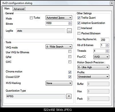

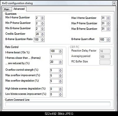

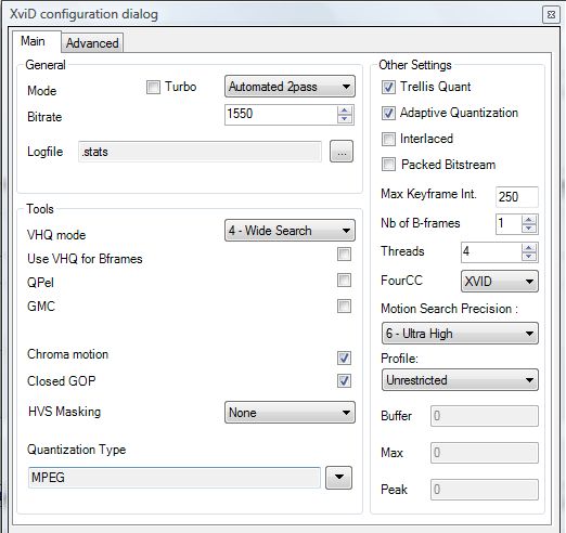

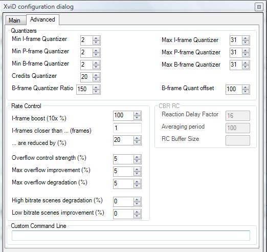

    Megui is different from the standard xvid settings so I send them to you.

    A far as I can see, it seems that I have the same settings, regarding the B-Frames. Right?
    I read, maybe even from you, that the Quantizer range should be reduced to 2-4 instead of 2-31. Should I change it that way?
    Although I need a xvid, I did a x264 encode and got a 1120 MB file. So I guess a file may saturate a codec but not another one?
    I installed avi.net (seems to be a good program) and see if I get the same kind of xvid file.
  8. Yes, many of those settings are similar. I do mostly 1-pass constant quant encodes these days because I usually don't care what the final size is. For 2-pass encodes, yes, I severely restrict the I and P-Frame settings, usually to 2-6, but sometimes to 2-4. I don't think mine has a min/max B-Frame setting.However, you had better know what you're doing if you restrict them that much because you're liable sometimes to get oversized encodes because XviD won't have the ability to use higher quants to keep the size down. Not with this current project, though.
