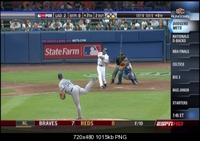

    Source (TFF, 720x480 NTSC):

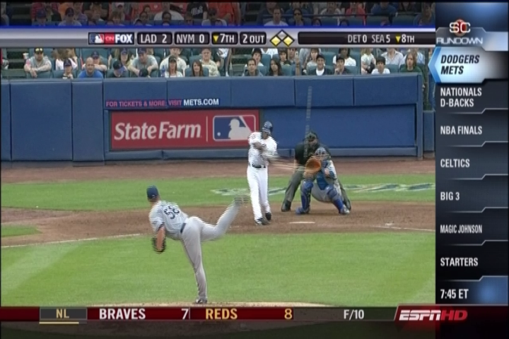

    First script:

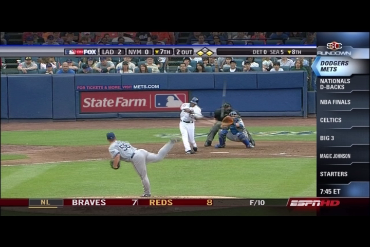

    Second script:
