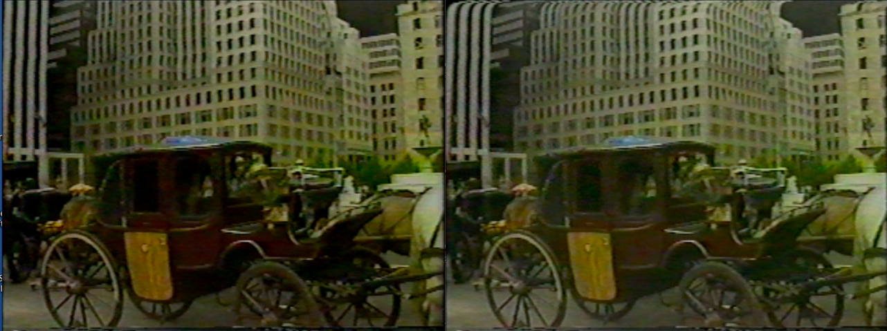

    Here's a screen shot of the Final Cut Express capture interface, showing the VCR's signal going through the AVT-8710 and through the ADVC, prior to inserting a tape. I wonder what the horizontal pattern is at the top. Whatever it is, it is more easily discernible on the HDTV that I use for monitoring than in this screen shot.
Name:	VCR Signal thru AVT-8710 & ADVC.png

    Re: my above screen shot. This phenomenon happened again, only this time, a recognizable image from the most recent videotape I had attempted to capture remained in the upper part of the screen, rather than an unrecognized pattern, after aborting the capture and removing the videotape from the VCR. A horizontal slice of the top of the last captured frame from the videotape continued to be generated by the AVT-8710, apparently still in its buffer.
    (When I posted the screen capture, I apparently hadn't noticed it until attempting to capture the next videotape.)
    This happens with the problematic videotapes, so far not with videotapes with no known problems. Does this tell us anything about what is wrong with those videotapes?

    Here's a side-by-side comparison of two captures of one of the problematic tapes. At left: Canopus ADVC110 only, no TBC. At right: AVT-8710 between the VCR and the ADVC110. Notice the "tearing" at the top of the capture done using the AVT-8710.
Name:	No AVT8710 at Left__With AVT8710 at Right.png

  28. Video Restorer lordsmurf's Avatar
    This one is easy to figure out!
    The tape is the problem. It has bad timing.
    Or it may be the VCR that made it -- or even the VCR now playing it. And not the tape.
    Read this for detailed explanation: VHS Tearing Even WITH TBC and JVC SVHS Player
    Now this error needs to be fixed by an embedded TBC. Not a standalone.
    Understand the different types of TBCs at: What is a TBC? Time Base Correction for Videotapes
    Your non-TBC Canopus capture has very definite horizontal jitters (squiggling of linearity).
    It needs correction.
    Your with-TBC Canopus capture has the same distortions. Again, missing a TBC.
    This comes back to the VCR. What VCR?
    Without reading the whole thread again, I'm guessing it's low-grade consumer junk, yes?
    And not a high-end JVC or Panasonic VCR?
    Learn more: Best VCRs for Capturing Video a.k.a. VCR Buying Guide (S-VHS, D-VHS, Professional)
    Another option is an ES10 between the cheap VCR (or a pro VCR) and the AVT TBC.
    More details on what an ES10 is: Fixing VHS Tearing During Capture
    Also goes over JVC D-VHS units, which can have similar abilities.
    Your problem comes from the fact that the AVT-8710 is making the timing errors permanent.
    The Canopus box was mildly correcting the problem, but it still was not fixed.
    Honestly, the Canopus version is not much better than the non-Canopus version you show above.
    Both are pretty screwed up, in terms of the image geometry.
    Look at how wiggly the straight lines are in the architecture. That's terrible.
    The uncorrected signal is also causing fluctuating luma values. It's crushed into blacks.
    There is excessive chroma noise in the video.
    You really do need a better VCR.
    Or even a chroma-filtering capture device (JVC DVD recorder).
    Pre-recorded tapes are no more special than homemade tapes.
    They suffer the same chroma errors, grain noise and time base errors.
    In fact, retail tapes are often worse, injected with false anti-copy errors.
    The "no content" error is because the Canopus box is unable to lock a signal.
    Same for skipped/dropped frames, and possible audio sync issues.
    This is why the AVT TBC is required.
    So the AVT-8710 has not "added" anything -- it's just not removing what's already there,
    either because the VCR is doing it, or because it's present on the tape.
    The computer can still be a cause for dropped frames.
    Most TBC-corrected dropped frames errors are actually related to the computing hardware.
    This was easy to solve, seeing the images, and getting more details from you.

    These images demonstrate that the TBC performance of the Canopus is better than the AVT for this type of timing error.
    If the AVT is not adding anything, then the Canopus must be doing a better job of removing the timing errors.
    If the Canopus is not removing any timing errors, then the AVT must be making things worse.
    I suspect that a Philips HDD/DVD Recorder used as a TBC in passthru would remove these errors, similar to the ES10.
    It would also provide frame synchronization, so the AVT would not be necessary.
    Life is better when you focus on the signals instead of the noise.

    But the Canopus is still missing MANY sync/timing errors, based on the geometric distortions in the architecture. While it does seem to help more with the one specific tearing issue, it fails at everything else. I would argue that it's "fixing" or "removing" the tearing -- it's just reducing it from what I can tell.
    Indeed, the Philips may have some degree of corrections. But again, it won't be able to account for all errors. That's why multiple TBCs and frame syncs may be needed. And that starts at having a good VCR.
    In fact, there's a chance all of this is the fault of the VCR.
