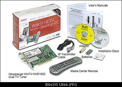

    I'm not currently capturing SD with my HRV-1600 but there is an S-Video input on the current model card and a supplied adapter for composite in. This is what you get. The little adapter is for composite in. You need to select composite or S-Video in the WinTV software during tuner setup.
