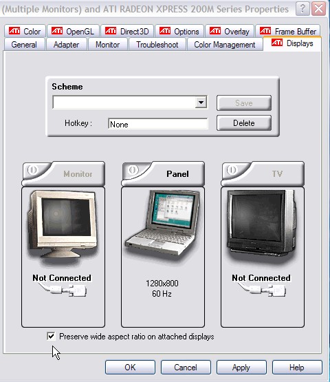

  12. Check the settings in Display Properties(or the ATI/nVidia icon in the system tray), there you can tweak the settings for the display:

    moviegeek,
    the display properties for my graphics driver (Intel 945GM) doesn't have those kind of options.
    I'm going to search for the thread by edDV and this is all good stuff as it's narrowing down the problem
