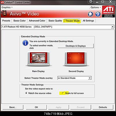

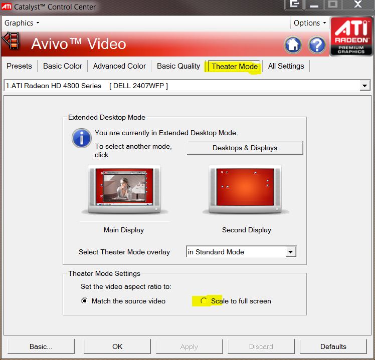

    And try Graphics->Avivo video->Theater mode->Scale to full screen. See:
