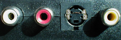

  3. in another forum (http://www.rage3d.com/board/showthread.php?t=33658934), i found this tip :
    And it worked! altough the colors weren't that good. But this means i can buy a new scart-piece that gives me colors. But how will i know the new one will work?
