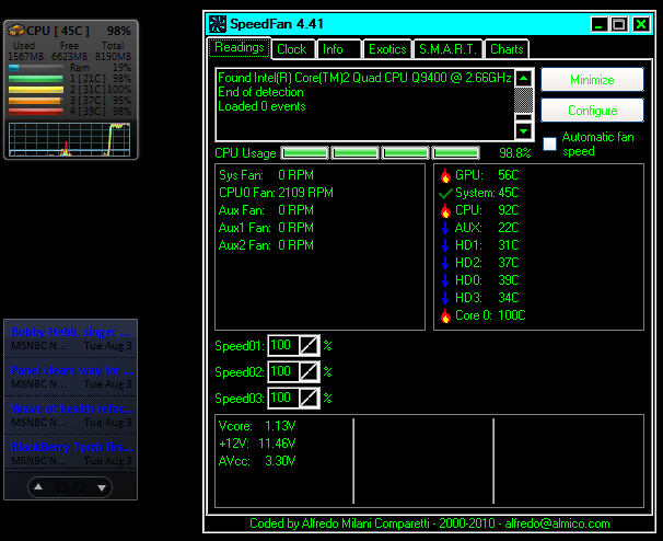

    Now, I do A LOT of video encoding. I have noticed that my computer has been continually getting more and more sensitive to the CPU overheating, especially the last couple of weeks. Before, my computer would turn off if I tried to multi-task while encoding a video, and recently it turned off when I was playing a graphics-intensive PC game. Today, I tried to encode a video and my computer turned off after it had been encoding for about two minutes, using all four cores of my processor. (My computer has turned off many other times because of the CPU overheating; those are just a few examples.)
    I searched around on this forum and someone recommended to try a program called SpeedFan to see how hot the CPU gets and also to clean out the computer. In all honesty, there was not a lot of dust in my computer, (because I sometimes vacuum the inside of my computer whenever I vacuum my house) although there was some in the CPU fan grills when I looked closer. (I hadn't noticed it before because of the fan blades.) I took the CPU fan out and blew out all of the dust.

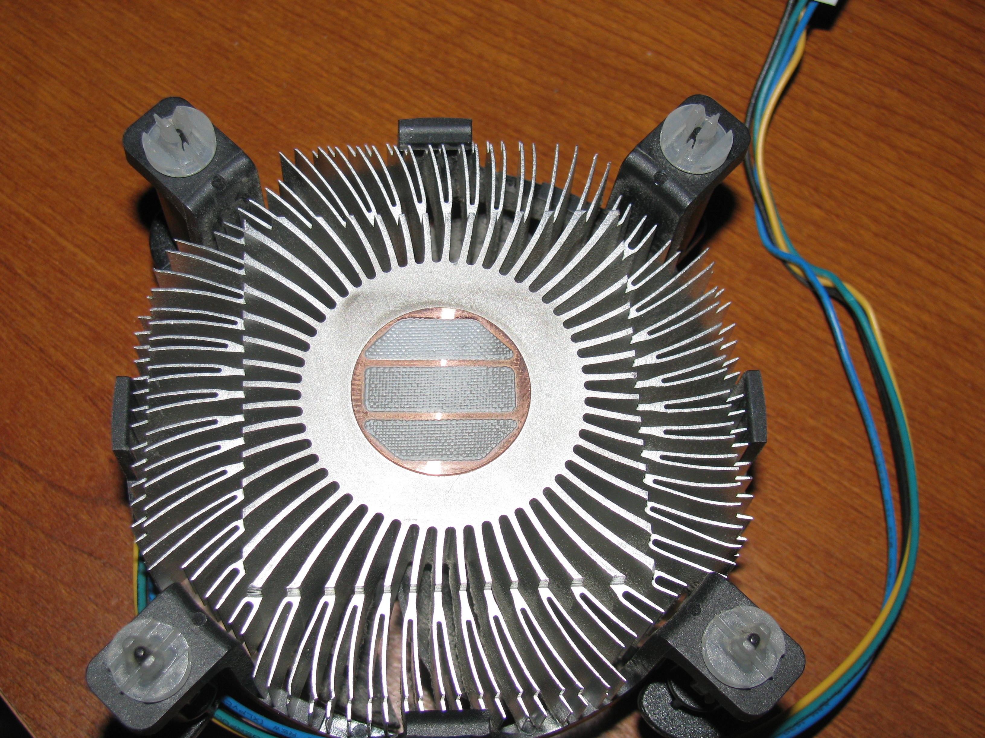

    When I had the fan out, I noticed that the thermal paste was worn down pretty thin (or so I think; I don't really remember how thick it was originally) and was also not in the slight bit sticky, so all I did was detach the fan from the motherboard with no resistance. (NOOB question: Are CPU fans even supposed to come out that easily? Aren't they supposed to be almost permanently stuck to the CPU?)
    I took a picture of the CPU fan ("IMG_5682") where you can see the thermal paste. It's also noticeable that one of the strips of thermal paste is a little thicker than the other two and cleaner. It also makes me wonder if the CPU fan isn't quite pressed up against the CPU evenly and firmly, though it feels pretty tight on the motherboard. When I built this computer (in February 2009, my first build), I used the generic thermal paste that came with the processor (which I think was already adhered to the CPU fan in those three strips) and was pretty sure that everything was installed correctly.

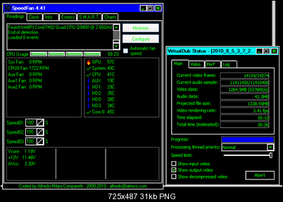

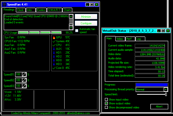

    Now then, I put the CPU fan back in, turned on the computer and tried encoding a little bit of video. I took a screenshot of the Windows desktop utility that measures CPU use and SpeedFan. ("overheating CPU...") So, apparently, the dust wasn't the problem.
    I should also say that I watched the temperature readings in SpeedFan while I was encoding once before I took that screenshot. The CPU temperature rose to 100°C and just stopped, while the "Core 0" temperature also rose to 100°C and then dropped to a negative number, and then began climbing towards 0°C before my computer shut off. So, basically, my CPU gets so hot that SpeedFan (or whatever senses the temperatures) aren't even programmed to read temperatures that high!

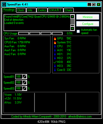

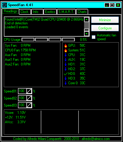

    For reference purposes, I also attached a screenshot of SpeedFan showing the temperature readings whenever my computer sits idle for a bit. The CPU temperature is typically around 45-50°C and the "Core 0" temperature is around 50°C. Though it gives the flame icon whenever one of them gets over 50°. (It also shows that my video card is running too hot, but I'll deal with that after this. At least that explains why I can't play as high-bitrate videos as I used to when I first built my computer.)
    I'm thinking that the thermal paste is the culprit here, because the CPU fan seems to run exactly as it always has and I haven't really noticed any major performance loss with low-processor-intensive type of activities, so I guess the processor isn't severely damaged. (Word processing, web browsing, music, etc.) (Though things have gotten slightly slower since I built the computer, but I suppose that's to be expected of any computer.)

    Most modern CPUs won't get anywhere near 100C. Most times the MB will lower the CPU speed/shut down the CPU at much over 70C. Extended temperatures above 90C will most often damage the CPU permanently. The top of the CPU will be darkened and it may be dead. You don't seem to have that problem, so I'm not sure your temp readings are correct. Speed Fan is a good program, but may not work correctly with all CPUs and setups. Try the latest version of HW Monitor: http://www.cpuid.com/softwares/hwmonitor.html It may not be as accurate as Speed Fan, but it's easier to use and has less problems with configuring.

    I could not help from noticing that the picture of the heat sink IMG_5682 looked as if it was never used. If that is not a picture of a never used heat sink then it appears it never came in contact with the CPU, the reason for the 100c.
    Well, I took that picture after I blew all of the dust out of it, so that could be part of the reason. Although it's entirely possible it wasn't quite on the CPU like it should have been. But never came in contact? Wouldn't my CPU have overheated the first very time I maxed it out?
    Yeah, I'm not digging the case design either. Again, feel the air from the out fans. Open it up after it's been closed and in use for 10 hours. Did hot/warm air rush out? I don't know that it's giving good circulation. I think idiots design most computer cases. I'd say that "fine" for one setup may not be cool enough for warmer/hotter setups. Something to watch for.
    I'd think about flipping the back fans to push air out, then just removing the right panel fan. Leave it an open grill. Get that "through-flow" that redwudz mentioned.)
    It should be evenly glaze-applied with your finger. (Preferably your finger behind Saran wrap.)
    I answered one of your questions in this post already. And the air from the fans doesn't feel hot either.
    ...I see. That actually makes a more sense than the way my case is currently set up. Looking at the fans on the left side, it looks like it might be possible to reverse them, though the screws don't look too promising. I think I am going to reverse the fans, now that I've thought about it. (Why wasn't the case designed like that before?) I'll have to mess with it later though. Thanks for the tip! (Same goes to you too, redwudz.)
    Hmmm. OK, so I have either put the thermal paste into two small strips about 1/3 of the width of the processor apart, or evenly glazed with a plastic-covered finger.
    Honestly, the latter of the two makes more sense to me. Just thinking about it... Wouldn't a person want the thermal paste distributed over more surface area so it can do a better job of filling in more gaps between the two touching surfaces? With that being said then... Then would a person want just enough thermal paste to fill in the gaps, but not so much that it prevents the surfaces from touching or gushes out if the two surfaces are pressed really hard together?

    OK guys, I installed the Corsair H50 along with some decent thermal paste. (Had to get rid of the thermal paste that came on the H50 though.) First of all, I just want to think everybody for their help. I really appreciate it.
    Now, here are the new temperature readings when my computer is idling:
    Temperature readings when my processor has been under 100% load for almost an hour:
    So, there is clearly a big improvement.
    However, I've ran into a few problems with the overall cooling of my case. As you can see, my system temperature is higher than it was last time and sometimes gets over 50°C, giving the flame icon. My GPU is also starting to run around 60°C. If I could get these lowered too, then I'd be set to go.
