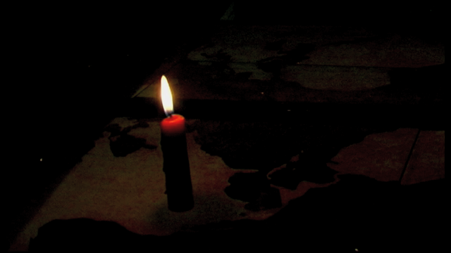

  1. I'm currently trying to make a video of a candle in the dark. But when I watch the video on the pc the black background has much noise and it's not perfectly black. I was wondering if you have some advice for me on how to get the background all black and smooth. Would I have to do it through editing the video after shooting or is there something I have to do (with light maybe) while shooting? Thanks in advance for your ideas and suggestions.

  4. Thanks a lot for your ideas. I have a Canon XL1 and acttally I played with the iris and the shutter speed but either I get the candle with a noise background or I get too much light so that you can see the candle and everything that's behind. Actually what I want is to have the candle that lights a worldmap underneath, but all the other surrounding perfectly black. So that's why i wonder how they do in professional movies with a perfect background and smooth objects in front of the background.
    http://a.imageshack.us/img534/7697/vlcsnap2010080700h43m15.png
    http://a.imageshack.us/img237/3369/vlcsnap2010080700h45m01.png those are images of the video as it is

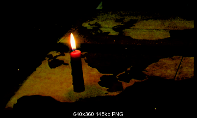

  5. I'm not exactly sure what you're looking for but:
    A little darker (brightness down, gamma up):
    The map is still visible but the background is pure black (except a few white spots).

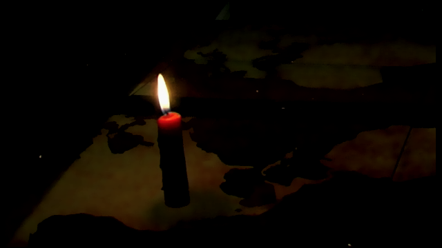

    Similar but with a very strong 2d noise reduction filter:

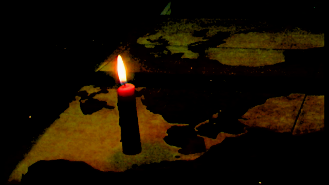

    More gamma (brings out more dark detail), no noise reduction:

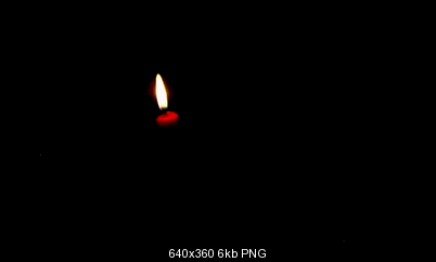

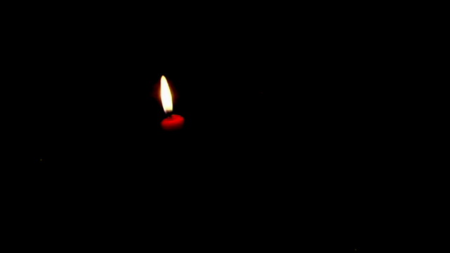

    A lot: (brightness way down, contrast way up):
    The map and the rest of the background are pure black.

    @jagabo: thx a lot for your support what I want is more like ur 2nd pic (Similar but with a very strong 2d noise reduction filter) maybe with the map a bit lighter...

  10. Originally Posted by Aymen View Post
    I did that in VirtualDub. I used the Levels filter to bring the brightness down and the gamma up. Then a filter called 2D Cleaner (noise reducer) to smooth it out. Note that the last step will cause posterization artifacts, blur away small details, and may not look good in motion. But maybe that's the look you're going for. Most video editors have those type of filters.
