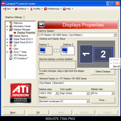

  2. Have you tried switching which display is the primary display?

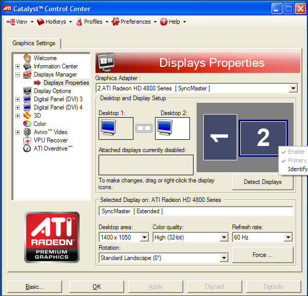

  6. Originally Posted by lordhutt View Post
    Is that an option in clone view? Both displays are the same....
    Yes. From CCC right click on one of the monitors and you'll see the options:
