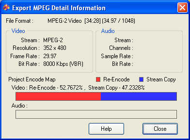

    I'm working on video that is 352x480. I'm tryng to put some text at the beginning. I used Sony Vegas to do it, with font size 16. I make a small video with text and joined it with the opera using Womble Mpeg. All is OK. But when I put this joined video into DVD-Lab it produces a DVD with low res text...
    Curiously, this image above isn't looks low res text... But when I play it on PowerDVD it looks like the image below:
    I run the video in DVD-Lab preview window and it is aceptable resolution for text, but when I make DVD the result resolution is very low... In despite res is 352 it shows 720 on PowerDVD. With GSpot I saw something like display size from sequence display extension. I think it says to player what res to play. At Vegas I checked write it to final file. Is it important here?

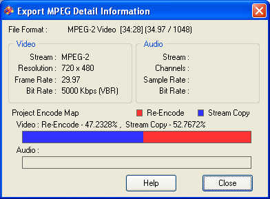

    I spent all my day yesterday and this morning, trying to make text in 720x480, but when Womble join the videos it goes to 352x480. Because I want the final size this. Womble re-encode first part (text) and direct copy the other.
    It's important to say that I'd like to use this res, because I wouldn't like to resize the whole opera. Just direct stream copy it. But to resize only the text intro is fine.
    But no way to have an aceptable result... I hesitated a lot to put this on forum to ask some help, because it looks so basic tasks...
    Some suggestions are very welcome
    Image Attached Images
    Thank you.
