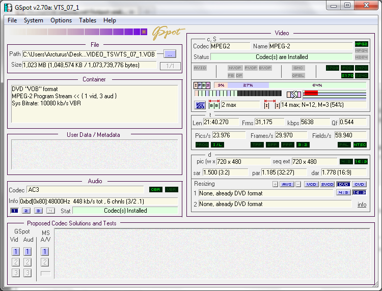

  7. Hi,
    I'm trying to attach or post a screen shot of the specs for the .vob that I loaded into GSPOT. From what I can tell, from your comments, it's a progressive mpeg with pull downs. The .vob that I loaded was the one ripped directly from the DVD.
    -vodmare.

  8. Yes, that's progressive with pulldown flags. Is that the source DVD or the DVD you made?
  9. That one was from the .vob directly off of the DVD.

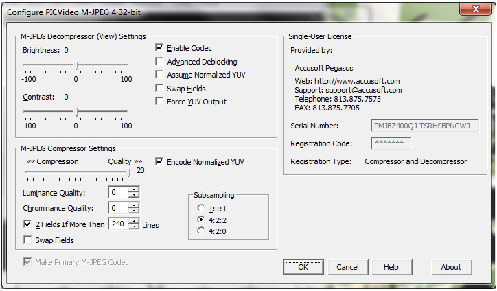

    Attached here is a pic of the controls screen for the codec, I never really screw with this area. Do you think any of these might fix the issue?

  10. Try turning off the "2 fields if more than 240 lines" option. Import the resulting AVI into Premiere and encode as MPEG 2. Then check the MPEG 2 file with GSpot.
  11. Hi,
    Okay. Turning off the 240 lines option fixes the interlacing problem. So that's good. But when I export from premiere, it comes up in GSPOT as 29.97 - 29.97 - 59.94 - I have to export as an .avi not an mpeg, would that be messing with it?

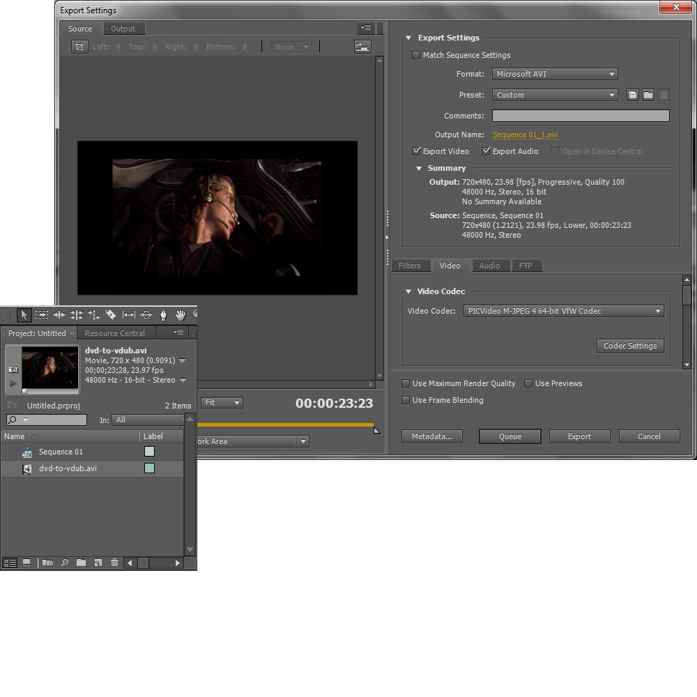

  18. Heres a screen shot, if that helps.

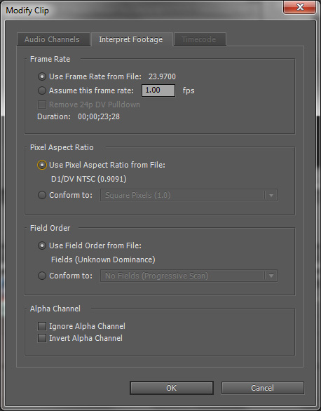

  19. right click the clip in the clip bin, and interpret the file to widescreen aspect ratio (premiere "thinks" it's 4:3 right now - it says 0.9091 for the pixel aspect ratio) . Also make sure you are using the correct matching sequence settings for widesccreen
  20. Here is what it was (below) - it's interpreted the same as the input, so shouldn't that still be correct? I mean, it must not be because I changed it to d1/dv ntsc widescreen 16:9 (1.2121) and that seemed to correct the size. However, now I've super bad interlacing, or really the edges are just very very bad, I dont think it's interlacing.

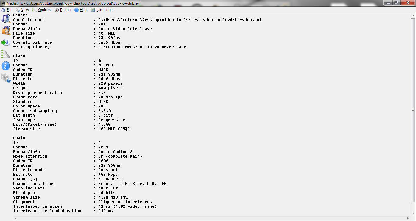

  22. What format did you export from vdub ? also what codec ? use mediainfo (view=>text)

  23. Here is the info using the tool you mentioned on the file that came out of VDUB. The codec that I used is the lossy version of the MJPEG PICvideo compressor. I am not sure that it has been IVTC, I assumed it was after using GSPOT to interpret the frames.
