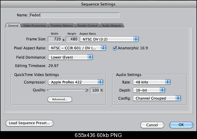

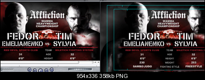

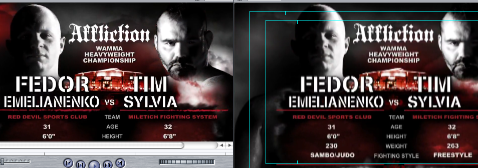

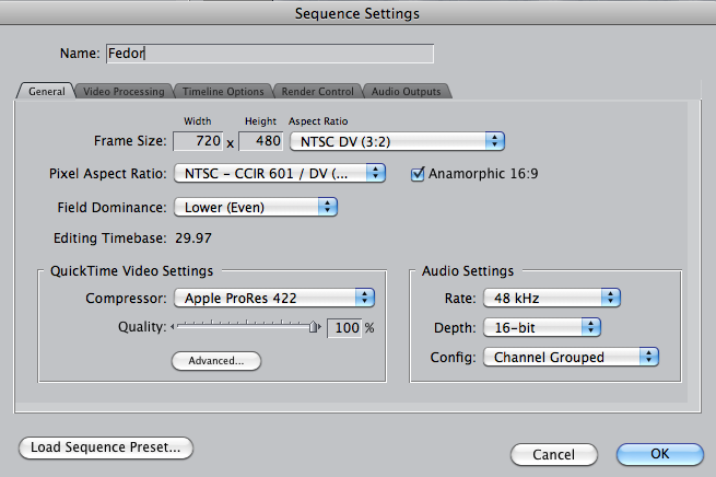

My PROBLEM comes when I try to bring in 720p HD footage into this sequence. In the viewer it looks great, but when I actually bring it into the timeline and play it back in the canvas, it is fuzzy and poor quality. I have included an image of what I am seeing, as well as the sequence settings I am currently using (first is the viewer and canvas side by side. Look for the difference in the letters to see the drop in quality. The second image is my sequence settings)

	Your taking a 720p file and smashing it into a 720x480 sequence. Your also making it interlaced. 720p is not 720x480.
 Of course you will loose resolution. Is this for DVD? If so, then you need to change your sequence to progressive 23.98 and export out a 720x480 16x9 anamorphic ProRes for your encoder. Are the other rips from the DVDs progressive or interlaced
