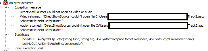

    Here is a screenshot of the error log :
    note: schnittstelle nicht unterstützt means Interface not supported
    I have read about such problem but couldn`t find the exact.

  2. sounds like you have directshow issues
    when you render the mkv in graphstudio, do the pins connect ?
    did you enable aac decoder in ffdshow , use win7dsfiltertweaker to ensure ffdshow is being used ?
    or you can use another source filter , e.g. ffmpegsource2 , and avoid directshow issues
    e.g.
    FFMpegSource2("video.mkv", atrack=-1)
    http://code.google.com/p/ffmpegsource/

    Thanks for the answer,
    I am not a prof but I will answer the questions.
    graphstudio is showing pins connected.
    aac is enabled on ffdshow and using win7dsfiltertweaker I have set the 32 bit to ffdshow but I have a 64 bit windows version and it is all set to microsoft.
    Regards
  4. If it's not connecting, or you have errors then directshow won't work for you.
    Double check to see you have haali media filter installed and registered and check again
    Everything has to match 32-bit for 32-bit or 64-bit for 64-bit , or it will break filter chain
    If you can't get directshow sorted out, I would use option #2 above and avoid all the headaches
