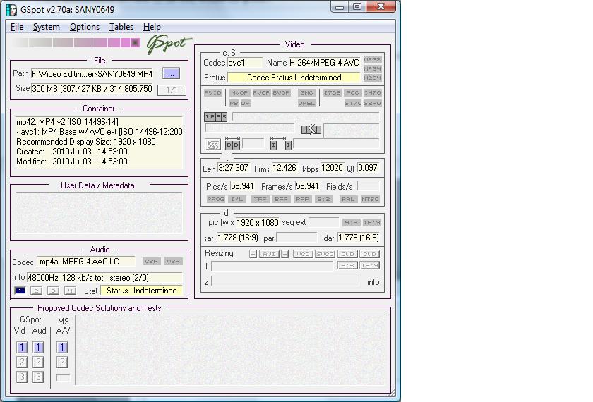

  1. I am editing two different sources of HD footage of my wedding. The main camera is a Pansonic TM300 and shoots in PAL 1080i (MTS files). The other camcorder was a Sanyo Xacti (not sure of model but it was bought in the USA) - and seems to shoot in 60p (59.941 fps in MP4 files).
    I am editing in premiere pro - how can I edit these two different sources together? My project is 1080i 50 I think.
    I guess I need to convert the 60p to PAL somehow. I have tried looking to instructions on how to do this with AVIsynth but without much luck as I dont really understand the process.
    Any help and advice would be appreciated. If you could get me an avs script and how to use it for example.
    edit - I'm not sure if the Sanyo footage is 60i or 60p?? Is there an easy way to tell? This is what GSPOT had to say:
    https://forum.videohelp.com/attachments/2912-1280699329/gspot.jpg

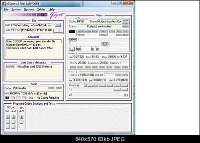

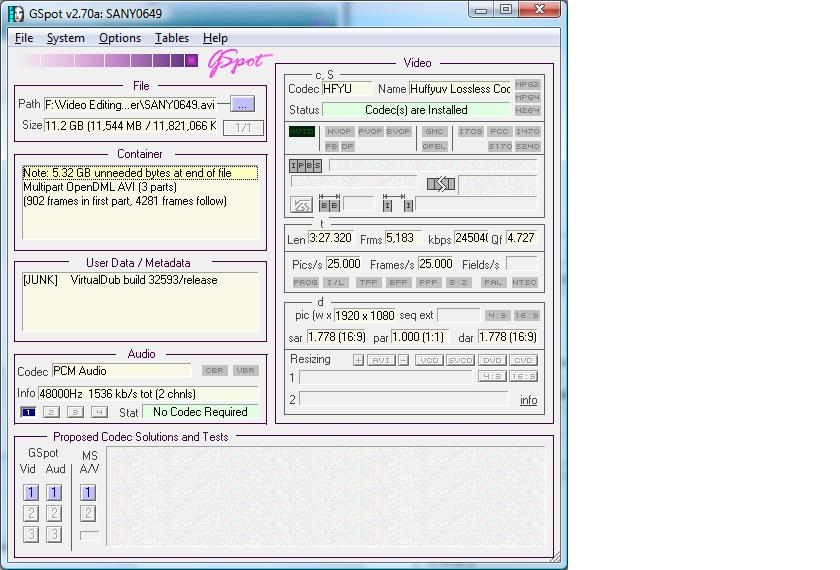

  16. Hmm a 300MB MP4 file is coming out at 11gb using Virtualdub, huffy codec and the avs script. I have about 15 of these files so I wont have enough HDD space.
    Any other codec options? No way to keep it as is but wth different fps?
    Why does gspot say there is 5GB of uneeded bytes at the end of the file?
    EDIT: tried to encode this new 25fps AVI into a DV mpeg for proxy editing using Adobe media encoder. Its not converting it - just sort of freezes and doesnt do anything.
