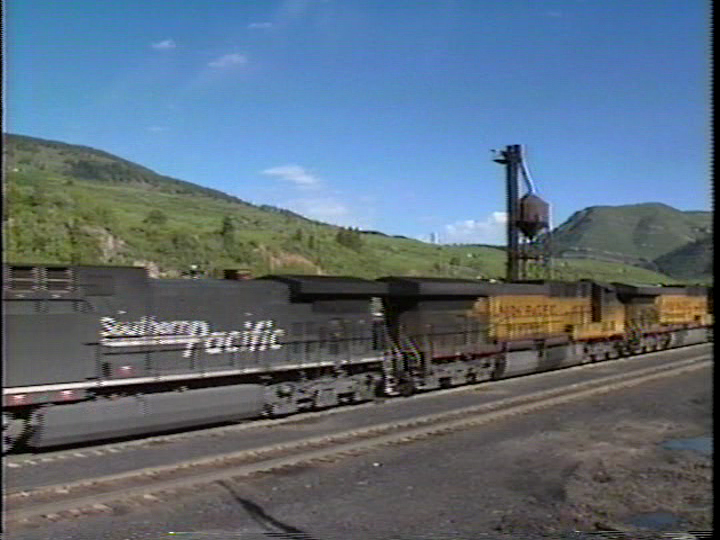

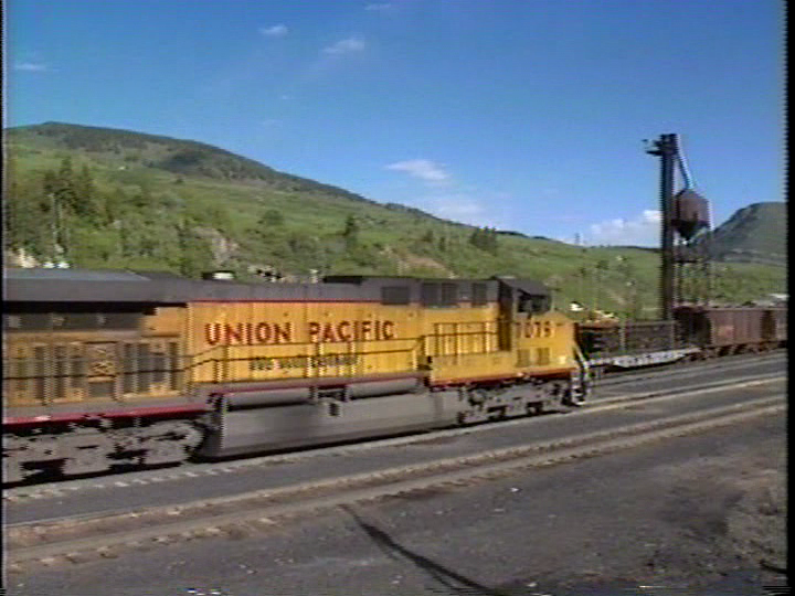

  6. Okay below is what I am talking about, although I remember it being a bit worse than what I grabbed a screen shot of. You can really see it in the white writing of Southern Pacific against the grey and then in the other picture, in the black vents against the yellow engine body as well as the red Union Pacific too. These aren't that big of an issue but it does distract from watching the video. Anything I can do to improve this?
    Thanks,
    Brian

  7. Those are interlace comb artifacts, perfectly normal for a VHS source. You need to use a player that deinterlaces on the fly. Try VLC -- once a video is playing select Video -> Deinterlace -> On, then Video Deinterlace Mode -> Bob or one of the other options. Any DVD player software on the computer should deinterlace by default.
    If you're planning on uploading to Youtube, or can't control the player, you will want to deinterlace first. That will cause some loss of quality though.
    TV's display video as interlaced. You just didn't know it until now.
    Don't deinterlace if planning to watch on TV or archive.
