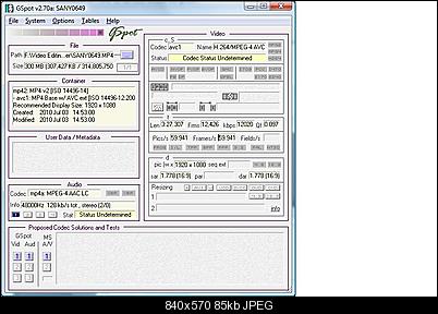

    Edit: Opened the MP4 footage in GSPOT - says the footage is 59.941 frames per second? Although when I import it into premiere it says 14.99? Any ideas why? - is the footage from the Sanyo actually 59.941 FPS? Is this 60p? The footage from my main camera is 1080i - what should I do?
