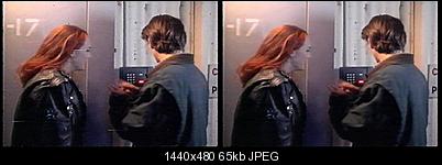

  6. VHS sample before and after RemoveDust() (requires RemoveGrain package):
    function RemoveDust(clip input, int _mode)
    repmode = 16
    clensed = Clense(input)
    rep=Repair(clensed, input, mode=repmode)
    return RemoveGrain(rep, mode=_mode)
    WhateverSource()
    RemoveDust(last, 3)

    Jagabo, yea the videos kind of look like the one u have above, that is what is needs to be removed.
