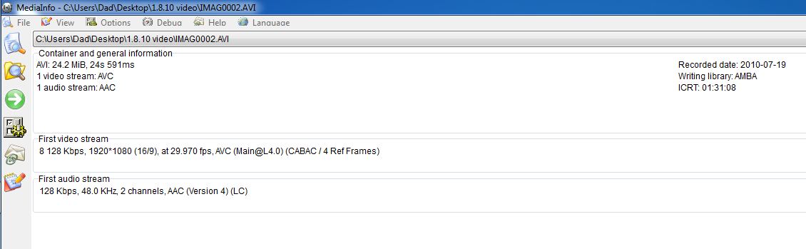

    Hey guys,
    I recently bought a lothone high def camcorder and after recording lots of short clips I tried to join them with all my regular software eg. tmpenc express, arcsoft mediaimpression etc. My software doesnt seem to like the file format of the videos. Do I need a specific codec? can anyone help me work this out?

    The files open in avidemux. Do my video files use B frame as a reference? how would I know?
