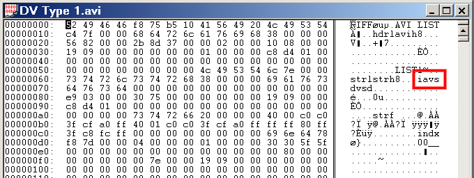

    Maybe if you change the video stream header from "vids" to "iavs" the audio will play.
    I like this idea. But it will be my first time using a hex editor.
    Any recommendations? I think I'd rather do it on the Windows netbook than on the Mac.
  3. If you have VirtualDub it has a built in Hex Editor. Tools -> Hex Editor. I use an old (free) hex editor from hhd software:
    http://www.hhdsoftware.com/

    (DV)*.AVI can be either Type1 or Type2. And, like jagabo is suggesting, if you change the RIFF header info to reflect a IAVS stream as opposed to an VIDS stream (and leave the AUDS stream alone), it should do the trick. You might be able to find a "RIFF Viewer/Editor" (I used to have a copy somewhere), but it is probably just as easy to do the hex edit. Just make sure you save an original copy of the file FIRST.
    I downloaded Virtualdub's latest beta version onto my Windows netbook. I used its Hex editor and made exactly the change shown in your screenshot above - to one of the aforementioned test AVI files.
    Then, I tried playing the file with Windows Media Player. The audio plays now. But gosh, something really weird happens to the video upon playback -- as if blocks are not being decoded, or something like that.
