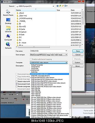

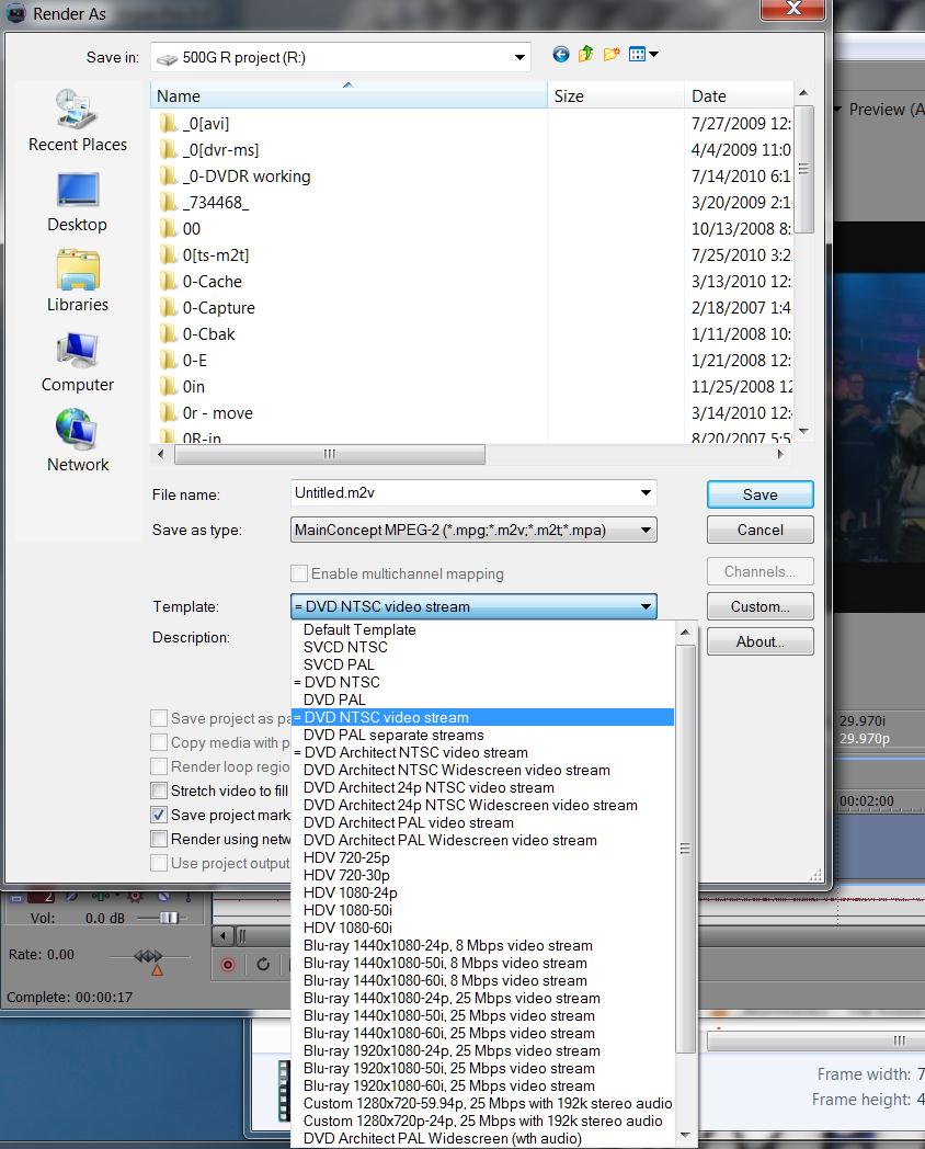

    You should be seeing most of these choices in v8. Each has extensive custom template choices.

  8. Member edDV's Avatar
    Mar 2004
    Northern California, USA
    Originally Posted by tonyp2 View Post
    Not sure just what DVD Architect NTSC Video Stream brings to the table.
    Those templates will open in the DVD Architect authoring program without a re-render. They would be DVD ready.
    You can modify under the "Custom" menu for many other purposes including reducing GOP length to 1 (all I frames). You need to compensate with more bit rate.
    The main benefit of all I frame Mpeg2 is editing ease but if you give it sufficient bit rate, quality will also be maximized. As said above the all I frame SD MPeg IMX format used in XDCAM can be 30, 40 or 50 Mb/s. The HD versions of the format use 15 frame GOPs.
    Its good for a beginner to experiment with these highest end formats so you have a comparision point for more compressed codecs or settings. You will be surpriced how much compression you can apply with small picture quality loss. Still, the deinterlacer/scaler in the HDTV will perform better with higher bit rate source.
