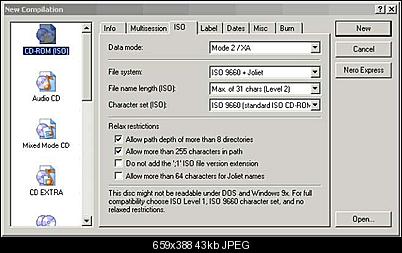

  5. See how to burn a upgrade disc. It's important!
    Burning upgrade software on CD-R or CD-RW
    http://www.p4c.philips.com/files/d/dvp5160_12/dvp5160_12_fur_eng.pdf
