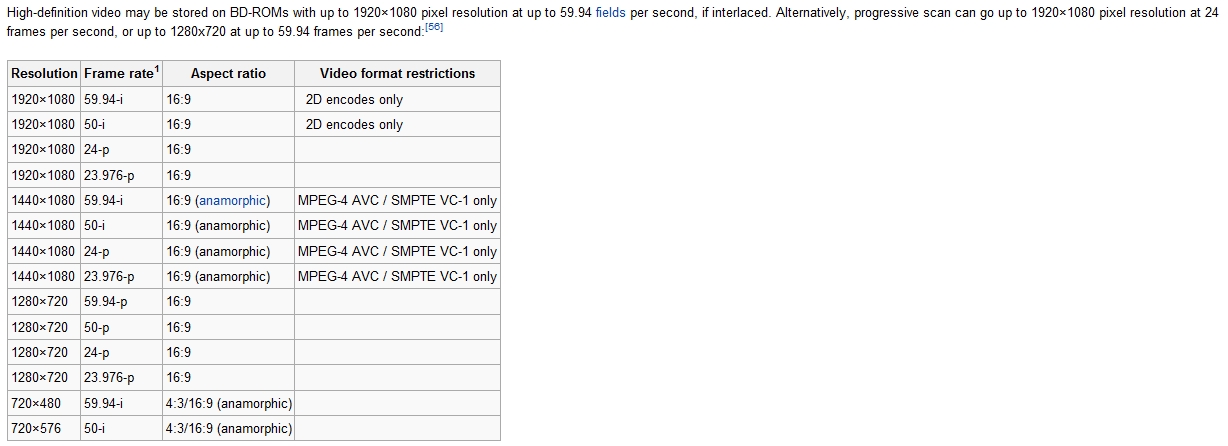

    the only allowed formats for 1440 and 1920 video are 16x9. so the side pillar bars have to be there permanently. even in 1440 anamorphic video.
