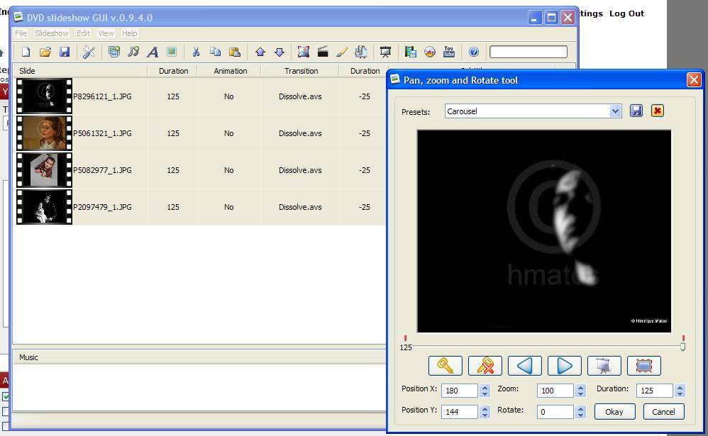

    I'm not sure it should be the same thread, but here it goes: I have this small slideshow, with very small jpg's, and when i try to create negative transitions over these slides with some animation (simple zoom out) the music stuters, the transitions slow down and, in the end of the transition, the slide "jumps" (zooms in) to the starting position, restarting the animation effect. Any ideas as to why this is happening?

  8. Hi.
    Thanks for the swift reply. I had actually rendered, but only to flv. I tried again, this time rendering to mpg and the result is the same. Created a new project and the problem arises when I add a third photo; after that, they all have the same problem.
    This small test project has 4 photos, all with a 125 duration and a "Dissolve.avs", "-25" transition. If my math is correct, at 25 frames this should generate a 17 second video. It doens't: the video has a total duration of 19 seconds; some of the pictures (apparently after the second) have a longer duration than the defined 125 (5 seconds), they start the animation and, after a few seconds (2, 3 seconds) kind of jump back (rewind?) to the starting position and redo the animated transition for the defined 5 seconds.
