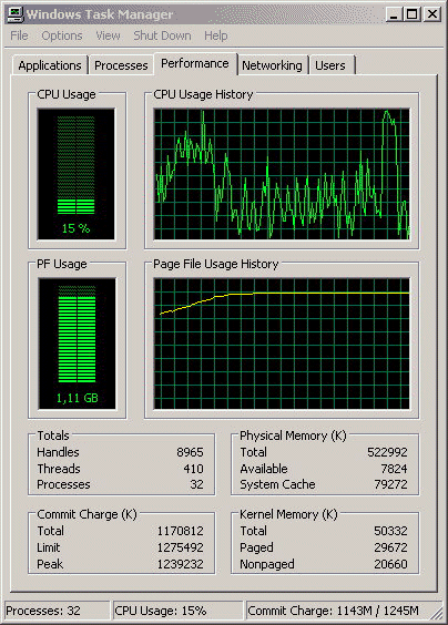

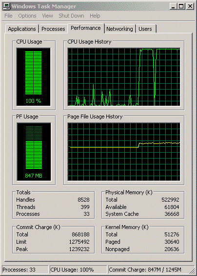

  15. It seems now, after doing some more encoding test's while monitoring system resources, that vegas uses alot of RAM when rendering to AVCHD.
    Resources used when using vegas:
    Resources used when using premiere:
    I have managed to increase the rendering speed for both vegas and premiere by doing some memory tweak's, so encoding a 1 minute AVI (1920x1080i29.97) now takes about 2 hours and 25 minutes with vegas, and about 27 minutes with premiere.
    The only way to further increase the rendering speed is probably done by adding more RAM.
    Vcd4ever.
