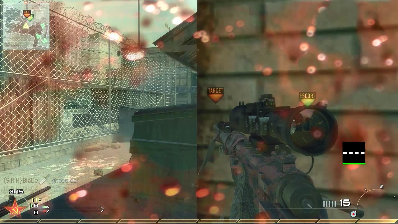

    This pic down there is an example comparing the 2 qualities. Now the pic on the right is a slowmo clip. The pic on the left is in real time. For Some reason when i play the clip in realtime the video will get pixelated and the quality is bad. But when I upload a video in slow mo the quality is actually good. WHY???
    I'ld like to have the slowmo quality to play in realtime and look the same as the slow mo.

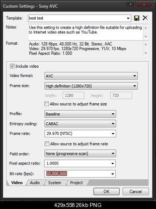

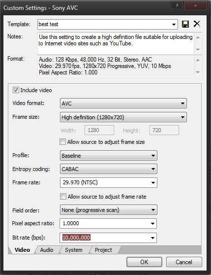

  11. Click image for larger version
    These are the settings I used and the bitrate is @ 10,000,000 the highest I can go for sony avc is 20,000,000
    What settings should I use to encode @ 50mbs? and I'm abit skeptical because in this http://www.youtube.com/watch?v=DMOxN-SJW50#t=5m38s video he shows that he encodes @ a bitrate of 10mbs in adobe media encoder. Maybe hes lying

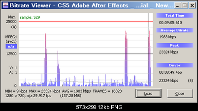

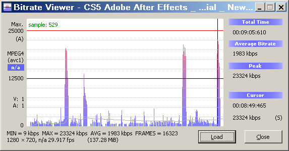

  14. Bitrate Viewer view of the other guys video:

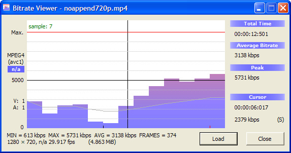

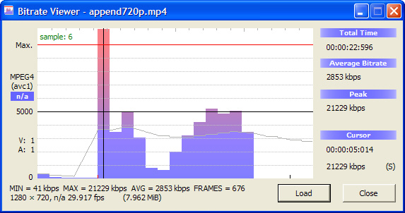

    Yes it makes a difference how you do it. Your intro/outro should be longer, and should match specs as the "main" part. FYI, the addional 5sec intro+ 5 sec outro only added up ~500kB more than your original video which was ~15MB = total 15.5MB, so it's not like it's a big burden to upload.
    http://www.youtube.com/watch?v=OVArZdzADYQ
    Have a look at the bitrate distribution ; the peak is 21Mbps in the appended version I did, it was only <6Mbps in your original (both downloaded from youtube)
    Have a look at the screenshot quality difference (Make sure you view at full screen size)
    It still looks like garbage later on (but better than your initial upload without the appended segemetns), so you'll have to fiddle with it to optimize it (maybe make the intro/outtro longer) . But it's youtube and I wouldn't expect that much
