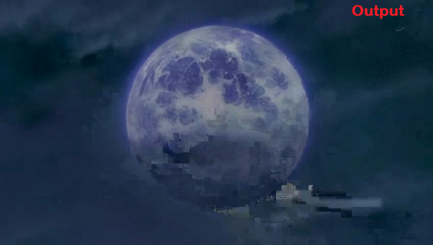

  1. I want to resize a 720p video ( Anime ) to 480p, but the output gets pixelated ( some kind of blocks ).
    Can anyone help me with this?
    What i did was, simply change the height and width values ( 1280x720 » 848x480 DAR 1.767 )
    Ps : I'm using meGUI

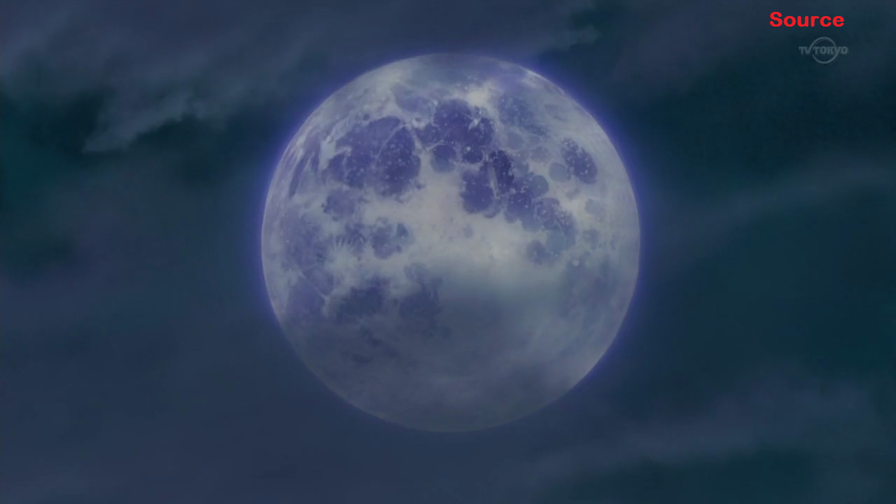

  5. No problems with the source. ( see the attachments )
Name:	Video Source.png

  6. This looks like corruption , or you disabled deblocking (in the decoder), or a weightp error
    What software and decoder are you using for playback and to take screenshots ?
    Did you disable deblocking in the decoder ?
    What happens if you play the output file in another player eg. mpchc, smplayer ?
    Where does the "blocking" occur? every frame? or only on dark scenes ?
  7. Those are encoding or decoding errors, not bitrate problems.
  8. This screenshots were taken on VLC Player. I have CCCP as decoder.
    If i play the file on mpchc i get the same quality.
    The blocking is only on dark scenes, and high motion scenes. (sometimes but very rare on bright scenes)
    Ps: currently uninstalling all codecs, and installing only cccp and core avc
  9. If you are using coreavc, make sure it's v2.0 or newer, there is a documented bug with weightp that causes very similar errors to that screenshot above
    What version of x264.exe ?
    If you try --weightp 0 , do you still get the errors in the encode ?
    For trouble shooting for now , I would reduce the qpstep (the quantizer might be making too large of a jump), and not use the nr for x264 (better filters in avisynth anyways)
    If you still can't get it sorted out after sorting out your codecs/decoders , post a sample of the source, smallest possible that can replicate those errors with your given settings

  11. For now, during troubleshooting, I wouldn't use any denoising filter. These errors are serious , and you want to not confound your analysis with other variables. Once you get it sorted out, then you could tweak your settings/filters. I didn't mention above, but it could also be hardware issue. I've seen this corruption with a bad memory stick , and unstable overclock before too. If your system is overclocked, reset to default for now.
    What version of x264.exe are you using? If it's not current update it from x264.nl
    Also post your avs script
    If you can, encoding only small sections that consistenly give you reproducible errors , so you don't waste time. You could use Trim() in your script for example, to encode a section , until you figure out what's going on

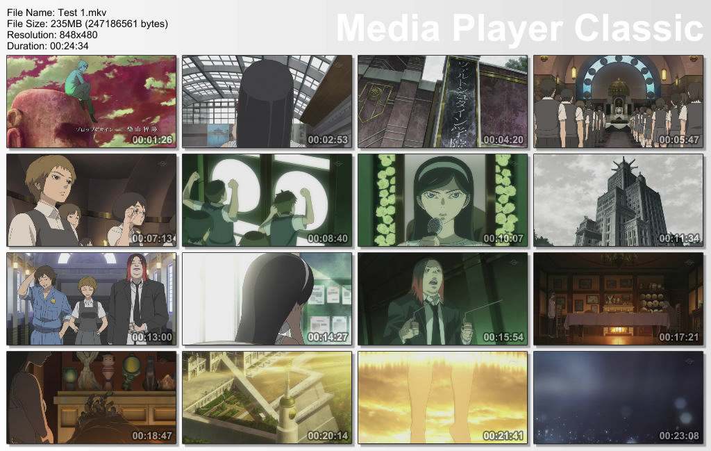

  13. Problem is solved .
    This was the changes i made :
    1 - Update x264
    2 - weightp 0
    3 - qpstep 4

Name:	Test 1.mkv_snapshot_00.01_[2010.07.27_20.16.24].jpg
