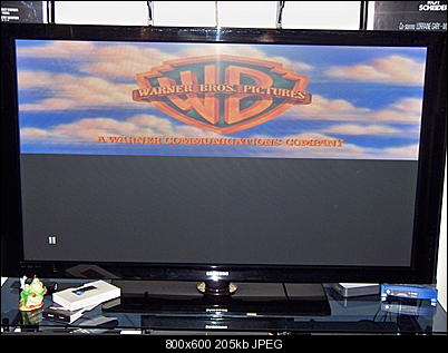

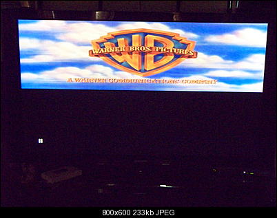

  1. I'm having a serious problem with authoring files that have been changed from PAL to NTSC. I've been experimenting with Blu-ray burning for the last few weeks and have had almost 100% success. All of my discs that I recorded myself using the Hauppauge or ones I downloaded in NTSC work perfectly fine. The only problem is this: the PAL to NTSC.
    Here's a re-cap of what I've done:
    I take the 25fps recording and put it into TSmuxer and demux the video/audio files.
    I then take the audio and put it into eac3to and slow it down to NTSC.
    I put the new ac3 file into TSmuxer and create a TS file, ticking the box that changes the frame-rate from 25fps to 24000/1001.
    I then take the resulting TS and use multiAVCHD to create the disc.
    Now, I've made barebones discs without any menu or any other files and I've made discs WITH menus and other NTSC-based extras. I get the same result when these PAL to NTSC discs played back on my PS3. Please note: the discs play back fine on my computer. Please see the pictures below.
ID:	2810Click image for larger version
ID:	2811Does anyone have any idea what might be causing this?

  4. mediainfo is reporting that it's 23.976 yet interlaced . Probably tsmuxer didn't do the framerate conversion correctly
    what are the source files? 25p ? 25i ? where are they from ?
    note: don't rely on mediainfo alone, because it just reports the header information and can be inaccurate

  6. If the source file is 25i (as in interlaced, 50 fields per second, 25 frames per second) , you can't simply make it progressive 23.976 . You have to deinterlace, re-encode and change the framerate. I suspect what you're seeing above is a single field not a frame .
    See, I put a 25i file into multiavchd and this is what happened.
    1920x1080 @ 25i (meaning 50 fields per second) is compliant spec for blu-ray and you could leave it as is. If that's what it was, it should work. If it was cropped, not full frame, then you have to re-encode and add the letterboxxing back.
    If you don't know what it is, post a sample

    If your file is interlaced, you would have to deinterlace first to get 25p, then do the pal slowdown . The deinterlacing requires re-encoding
    So was this a PAL TV cap ? from an original film source ? so the original rate was 23.976 ?

  15. You need to get your files to 1920x1080 24fps (or 23.976) but PROGRESSIVE or 59.94fps INTERLACED. There is no way to get 1080i@25fps (and 25 fields) working properly. That's why you get HALF of the height, because you're missing half the interlaced lines (for a source which should be 50i/50fields 25fps).

  18. There's no way around it. You have to deinterlace and to pal slow down (i.e re-encode it)
  19. Originally Posted by poisondeathray View Post
    You don't have to pal-slow down if I've already used tsmuxer. That slowed it down already.
    And, from what I'm told, it was actually broadcast in 1080p (UK broadcast) so there shouldn't be a problem with just altering the properties, as discussed above.
    Or am I completely wrong?
  20. If it was true 1080p25 (native), then you could the slowdown directly without deinterlacing. But obviously it's not working for you. You need a native 25p sample for it to work.

  21. If you 'changed it to progressive' just by altering the detected properties WITHOUT transcoding it wouldn't be of much help unless you TRANSCODE the file. Then multiAVCHD will do the proper deinterlace + resize and ouput the proper content.
