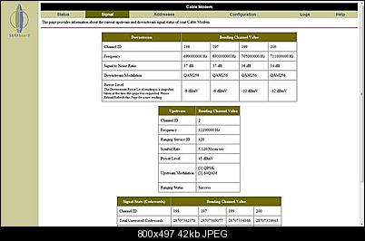

    use that ip for what? he is trying to access the modem's internal pages. like this.
