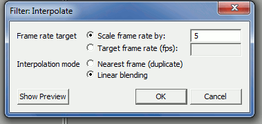

    Step 4: make the filter window like this:
    Step 5press ok and view the results in the output
    You are done.
