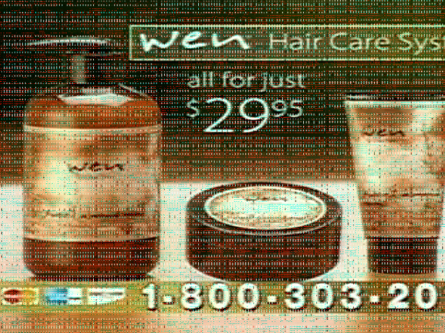

  1. On my older computer which I don't use much anymore I have this weird interference happening and thus until I find a remedy I won't do any more video capturing with it. I have a suspision this might be connected to the USB. I have one USB slot that has failed on the front and before it went dead when I would plug anything into that slot I would get artifacts like this on my desktop. Actually this interference pattern is bleading through on my desktop as well at the moment and nothing is plugged into the USB. The capture card for this computer is an ATI All In Wonder Pro. Thanks in advance for any advice you can give me on this issue. Have a nice day!

  2. I have hooked the computer to another monitor. It must be a problem with the ATI Card. My best bet is to get stuff off of this computer and abandon it. I tried to hook the monitor up to the computer's own video card monitor output and it said "no signal". The pattern is bleading into the desktop and any video I watch is distorted with the pattern.

    When you hooked the monitor to the on-board video, did you go into BIOS and change the display over to that video chipset? Otherwise you would get 'no signal'. From the screen shot, there is a serious problem. Might be the video card or a failing power supply or a dying MB. Lots of possibilities.

    I'm not convinced the card is the problem. That's more likely driver issues (corruption of files on hard drive, meaning a hard drive error), motherboard failure, VGA cable failure, or power supply issues (not enough power). I've seen this exact error, and it was almost never the card itself.

  6. I took the computer up town today. The technician tested the ATI Card and that is where the artifacts were coming from. He hooked up the monitor to the video card built into the motherboard and the artifacts went away.
