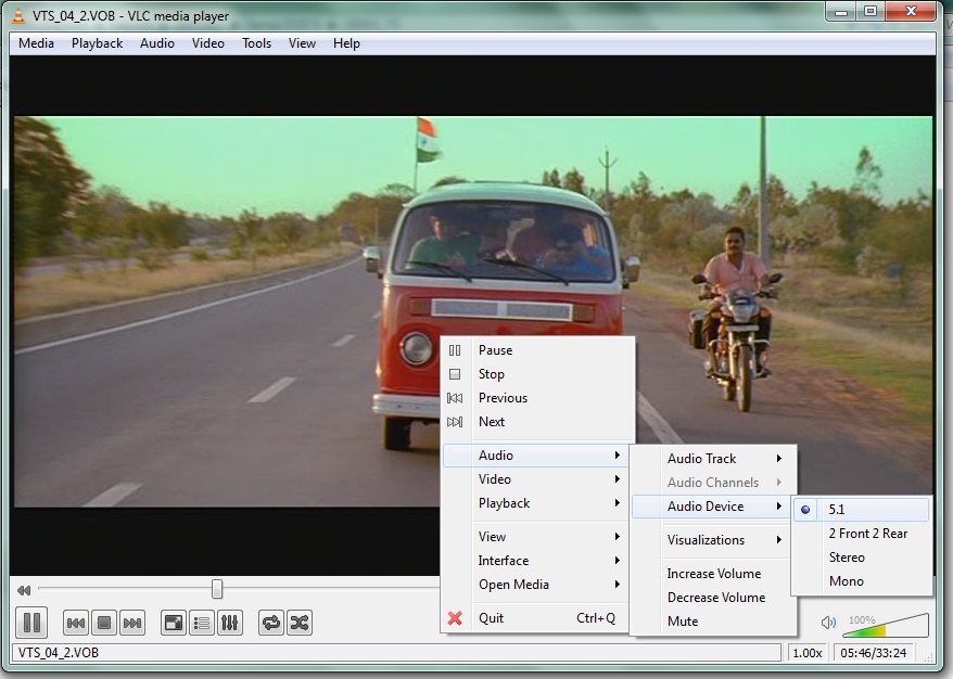

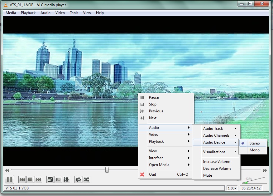

    ok let me explain in my term..
    all i want is the vob file should show like the 1st pic.. (5.1)
    but some dvds are not encoded with that option n show as 2nd pic.
    all i want to do is make the vob file as the 1st one. (adding 6 channels)

    so... i mess up when there is no option when selecting the channels to 6 channels. it only shows stereo and mono.
    thats i wonder that how to make a dvd file with 6 channels.

    usually a dvd with 6 channels hv audio without voice in the 1st and 2nd channel. 3rd channel is only voice contained. 4,5.6th are effects.
    thats y i wonder to make the dvd file into 6 channels.
