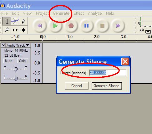

    I noticed earlier (when joining-not that Im doing it now) that I was getting errors such as "this segment has a different number of streams"... Im assuming this was because some of my videos have no audio soundtrack, so I am wondering (if I ever needed to do it) how I would go about adding a track of silence?
    Is there an easy way to do it? Just incase I join them all later in a different program and receive errors, Im trying to find out the easiest way to add a track of silence, without having to use full processing mode on the video? Perhaps I am better off using a different tool to join them than virtualdub, but if I receive the same error I may have to add a track of silence anyway.

    I don't know if you use Audacity, but you can generate a silent audio track and save it .
    Load it into VirtualDub from the Audio menu.

  8. I have audacity, thats a good point-simply add an audio track to the video using virtualdub! ill try that if I have any problems when joining - I only know of virtualdub and the utility in my first post as freeware to join video, hopefully I wont receive any errors when doing so, but if I do ill post here.
