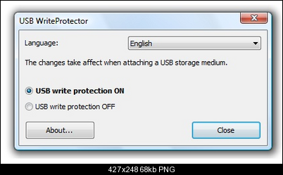

  2. Try using USB WriteProtector and just select USB write protection off, these days manufactures are saving money by not having a switch on the USB sticks, so you need to use an application to switch it off, the common cause for write protection switching it self on is, disconecting the USB stick before finishing a transfer on it, thus it locks it self to read only.

  3. Thanks tried USB WriteProtector but it did not resolve the issue....
