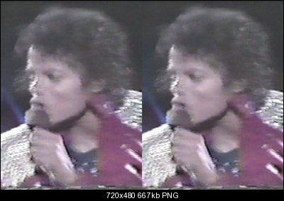

    observation: if you pick selecteven() with tgmc , frame 11 looks better than when using selectodd()
  2. The top field of frame 11 is the one with that squiggle in MJ's nose. Here's frame 11 with VirtualDub's Deinterace/Blend (left) and AviSynth's Blur(0, 1.0) (right):
    They look almost exactly the same to me.
    Keep in mind that both fields can have time base errors so keeping one vs. the other won't fix the problem, just move it to different frames.

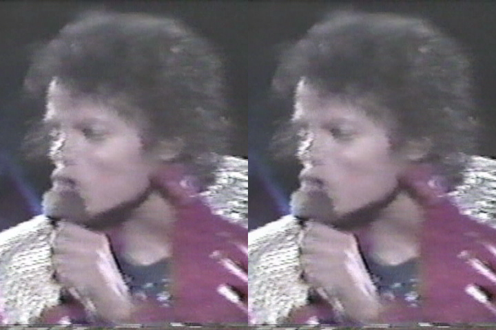

  3. Maybe trying out different blend deinterlacers could get rid of the double images ? or maybe you can adjust the amount of blend ?
    Here are some comparison shots of the same blend deinterlacer above in vdub, vs. one in after effects
  4. Thank you both for your answers
    AE blend deinterlacers looks really great. Far better than vdub. Why?
  5. Not sure, it doesn't look to be blending anything , just blurring everything slightly
    Regular avisynth deinterlacer (e.g. yadifmod +nnedi2 , even nnedi2 alone) is even better , more sharp, less aliasing
    The only difference in the jitter artifacts in your earlier posts was selecting different field. Blend deinterlacers suck.
  6. AE looks like it's doing a discard field and resize, plus a blur. That would be Bob with Keep Top, or Keep Bottom, in VirtualDub's Deinterlace filter. But again, no matter which field you keep, some of the resulting frames will have horizontal time base jitter.
    AE looks like it's doing a drop field and resize.
    what is a drop field?
  8. Drop field and resize: discard one field, resize the other. Note that I added more to that post.
