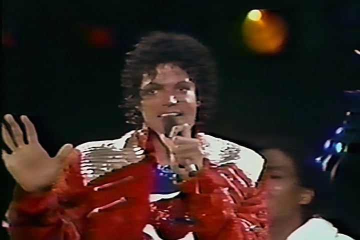

  2. Originally Posted by pirej View Post
    I tried VideoFred's script for restoring 8mm film, and.. i kind of like it
    [Attachment 2801 - Click to enlarge]
    I did color corection as jagabo's example
    ColorYUV(gain_y=60, gamma_y=-50, off_y=-55, cont_u=400, cont_v=400, autowhite=true)
    Tweak(hue=-30)
    ChromaShift(c=-4) #shift colors left by 4 pixels
    And i added colormill tweaks..

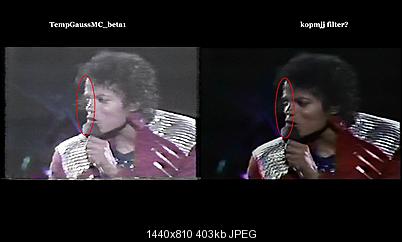

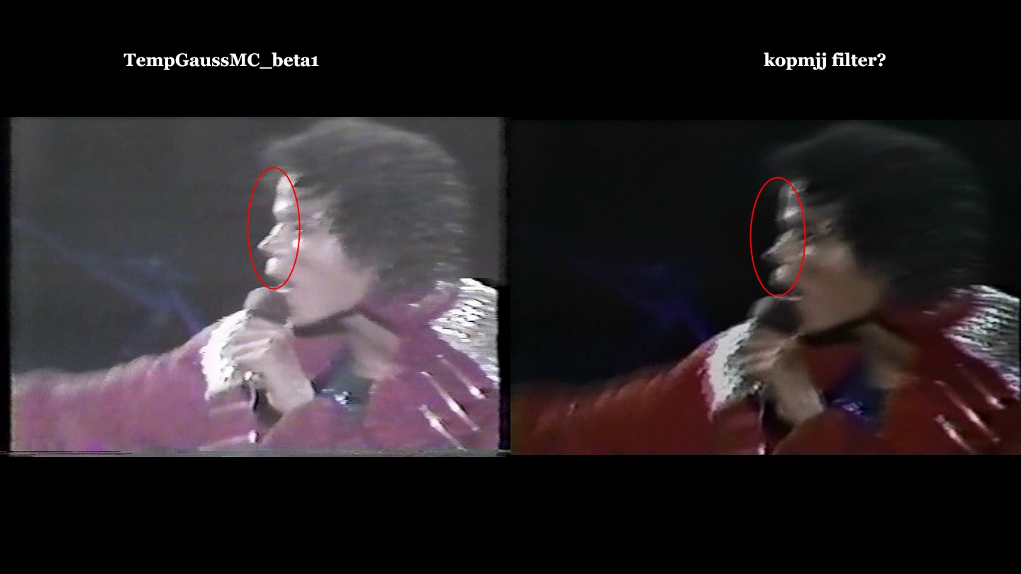

    I had a quick try with Jagabo's script and I noticed two things:
    - the "Weavy line" effect on MJ's left face, as mentioned by poisondeathray

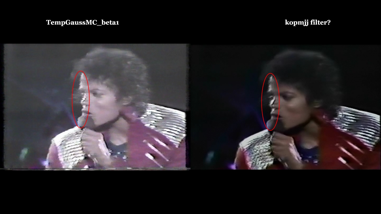

    - there are double exposures when there is motion. Jagabo you guess he used an old deinterlacer that blended motion areas. Which one for example?
    Do we have to choose between the "weavy lines" and this "double effect" or is there a way to get rid of both?
  3. You might use virtualdub's internal deinterlace filter set on "blend" . That gives the almost exact double images in kopmjj's version that jagabo noted earlier. In avisynth , there is one called smoothdeinterlace, and there is a blend mode.
    It's odd, because usually you strive to keep details, not blend and blur them away. I never use a blend deinterlacer if I can help it - but maybe it's better for this type of source?
    The thing that bugs me the most about this is the wavy motion or frame warping. It's the stillness and calmness of kopmjj's version that appeals to me - mathmax you said the background was very calm earlier - that's what I mean. Somehow his version has all straighter lines, and less wavy line motion, and it's not as simple as antialiasing. You can't really see it on a single screenshot, it has to be in motion. I think that 1st screenshot above is a different artifact, like motion prediction error from mvtools & tgmc, due to the jitter artifact (if you look at mj's sideburn , it's displaced horizontally, but in kopmjj's version, it's magically inline and straight; but it's not "perfect" because his forehead still has a "pit" from the remenants of deinterlacing)

    I tried to get the same settings, if it's not the same.. than it's really close.
    VirtualDub.audio.SetSource(1);
    VirtualDub.audio.SetMode(0);
    VirtualDub.audio.SetInterleave(1,500,1,0,0);
    VirtualDub.audio.SetClipMode(1,1);
    VirtualDub.audio.SetConversion(0,0,0,0,0);
    VirtualDub.audio.SetVolume();
    VirtualDub.audio.SetCompression();
    VirtualDub.audio.EnableFilterGraph(0);
    VirtualDub.video.SetInputFormat(0);
    VirtualDub.video.SetOutputFormat(7);
    VirtualDub.video.SetMode(3);
    VirtualDub.video.SetSmartRendering(0);
    VirtualDub.video.SetPreserveEmptyFrames(0);
    VirtualDub.video.SetFrameRate2(0,0,1);
    VirtualDub.video.SetIVTC(0, 0, 0, 0);
    VirtualDub.video.SetCompression(0x67706a6d,0,10000,0);
    VirtualDub.video.SetCompData(60,"EwAAAAUAAAAGAAAAAQAAAAAAAADwAAAAAAAAAAEAAAABAAAAAAAAAAAAAAAAAAAAAAAAAAAAAAAAAAAA");
    VirtualDub.video.filters.Clear();
    VirtualDub.video.filters.Add("Color Mill(2.1)");
    VirtualDub.video.filters.instance[0].Config(25700, 33892, 22372, 25700, 25700, 23125, 25700, 27236, 25700, 25692, 25700, 25700, 25700, 1124, 7);
    VirtualDub.audio.filters.Clear();
    But i think it would be better for you to try it you're self, and do a little playing with the setings.
    p.s. i did deinterlace first using
    interp=nnedi2(field=1)
    yadifmod(order=1, field=-1, mode=0, edeint=interp)

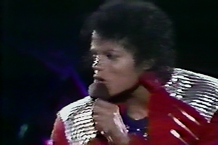

  16. Thank you very much. Your script works for me and the colors are really great. Maybe just a little bit saturated...
    Concerning DepanStablize, does it only fix global motion or also the image distortion? I mean, your video seems very calm just like if the image distortion is fixed in time. I guess that poisondeathray is speaking about this when saying "less wavy line motion". So I suppose DepanStablize shifts the lines one by one and not only the whole frames. A black strip appears when a frame is shifted because of global motion... but it seems more like a bug. Am I right? In that case it would make sens to fix these black strips. I'm just worried that fixing it just means cancel the action of DepanStablize...
    On the other hand, there are still these bad line on MJ's nose which are not there if I use a blend deinterlace filter.. And I still wonder if I can get rid of this without the double exposures effect of the blended mode.
    One more question: Jagabo advised to first fix the colors and then apply smoothing, denoising, etc. filters. Is this order really important?

    Well you can tweak the settings so they fit you're taste, saturation is easy to fix.
    DepanStablize stabilizes the global motion, so it shifts the whole frame, not a part/pixel/line of it, that's why the "black stripes" are unavoidable.
    The "calming" effect comes from MVDegrainMulti, it averages multiple frames.
    Those "bad line on MJ's nose" are not only on his nose, they are everywhere, allover the frames, and that's something you need TBC for fixing it.
    Maybe with blending they are less visible, but then.. the whole picture is "blured" and less visible, so that's you're choice.
    Try (instead of blending)increasing the denoising_strenght/frames to something like 2000/7, and increase the sharpening a little bit, do some experiments.
    I guess jagabo is right about the order, but i'm not shore.

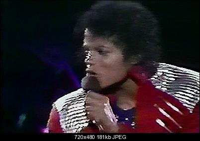

  28. Jagabo, just a question:
    You proposed me to adjust the strength of blending by changing the second parameter of Blur().
    But I cannot get rid of the weavy lines on the picture I posted just above by using the Blur() function, which is possible using deinterlacing in blend mode.
    So deinterlace in blend mode and Blur() don't seem to have the same effect...
  29. They usually work about the same for me. Can you provide a short clip with the frame from post #76 above?
