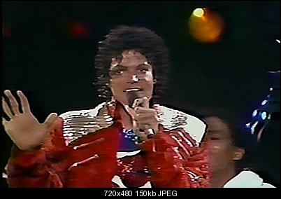

  20. I don't think noise reduction is the issue you're concerned with. Neat video can easily get rid of static type noise. Even at only 25 percent it's removed nearly all the noise:
    I think you want to reduce the jitter from the lack of a time base corrector in the original cap. The TMGC script I gave earlier comes very close to kopmjj's video. If you leave out the Blur() it will be even sharper.

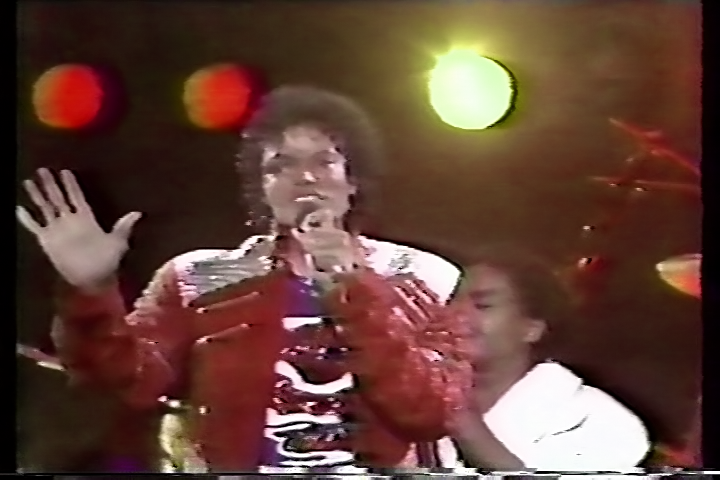

  27. I also i have this problem with the the black levels, I'm kinda new to use VirtualDub and AviSynth, I've always used Vegas Pro, so that's why I might have many stupid questions, hope you guys don't mind helping
    Source;
    My enhancement;
    What do I need to do, to also darken the missing part on right side?
  28. Are you talking about that white fringe glow?
    One way to do it is to use masks and layers. I think he ended up rotoscoping some things like the halo edges in after effects (but I think that was a different source video, a lot worse than this one) .
    You're basically applying filters selectively to specific areas , and animating those masks. It's harder to do in vegas alone, because the tools aren't as sophisticated

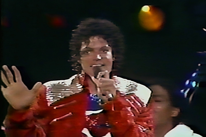

  29. Member pirej's Avatar
    Mar 2008
    Macedonia
    I tried VideoFred's script for restoring 8mm film, and.. i kind of like it
    I did color corection as jagabo's example
    ColorYUV(gain_y=60, gamma_y=-50, off_y=-55, cont_u=400, cont_v=400, autowhite=true)
    Tweak(hue=-30)
    ChromaShift(c=-4) #shift colors left by 4 pixels
    And i added colormill tweaks..
