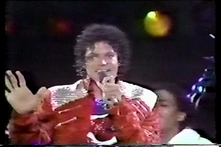

  2. Is this a digital file or from a VHS tape of yours?
  3. It's from a VHS tape
    But the video has then been transferred to my computer

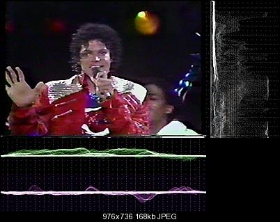

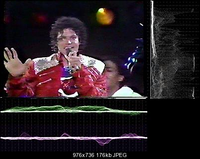

    This is quick edit with CollorMill, there other way's too..
Name:	with collorMill.jpg
  7. Could you tell me the settings you've used for that image?
    Mar 2007
    South Africa
    I'm not sure if I've done this right, as I've never tried to upload an image from my pc to here. When I preview the post it appears at the bottom of my post.
    Anyway, I used Virtualdub to do it. It was a quick adjustment based on the one frame sample.
    I used 2 'internal' virtualdub filters (they come with virtualdub). First the 'Levels' filter where I set the lower setting of the Input Levels to 48. My sample was done with the 'Operate in luma instead of RGB' box checked, but unchecking it actually appears to intensify the colours a bit, so you might want to try it.
    The second filter is 'HSV' adjust. Here the values were: Hue +39.7 and Saturation x177.5% with Value being left alone. The very precise numbers are simply a result of dragging the sliders!
    The exact settings may need to be adjusted a bit when looking at more of the video, but it's a good starting point. It actually took me more time to type this post than to do the adjustments!
    I hope this is helpful.

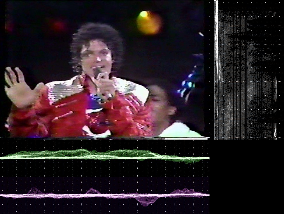

  17. ColorYUV(gain_y=60, gamma_y=-50, off_y=-55, cont_u=400, cont_v=400)
    Tweak(hue=-30)
    ChromaShift(c=-4) #shift colors left by 4 pixels
    Pulling the gamma down a little more will bring out some more color in his face.

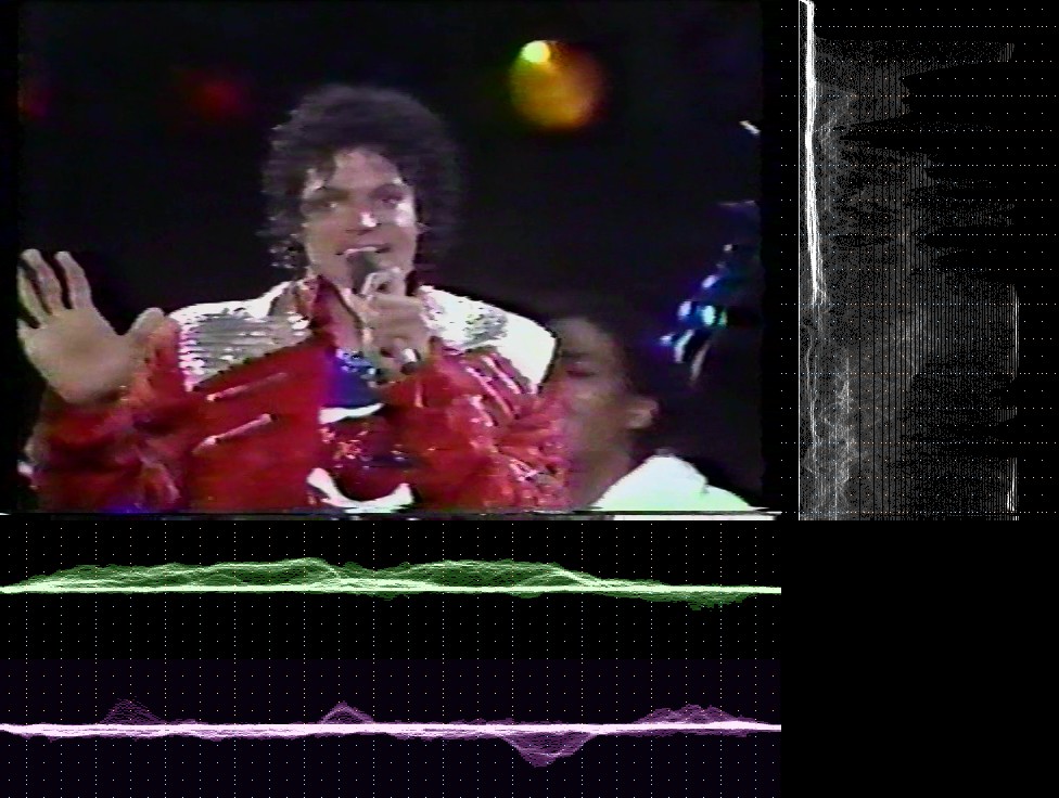

  18. Try this:
    ColorYUV(gamma_y=-120, cont_u=350, cont_v=350)
    Tweak(hue=-30)

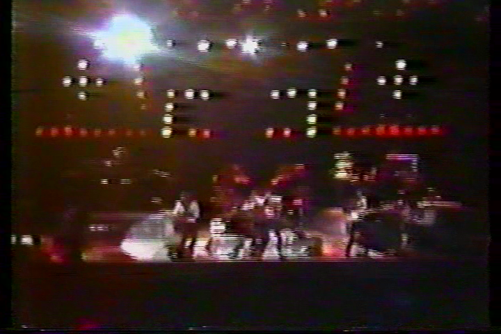

    How can I correct this green color-noise? :/
Name:	Green noise0000.bmp
  22. The above filters will help with that. They are temporal filters -- they require multiple consecutive frames. So you can't see what they do with a single image.
